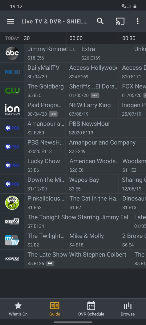

Not an EPG issue per se, but there’s also bugs with Plex displaying the “new” tag. I don’t have a comprehensive list, but for example, on the Android app the new tag is shown in the DVR schedule page for a show but not shown in the guide page for the same program. I’ve seen similar behavior in the web app as well. This isn’t the case in all circumstances. Note Steven Colbert.

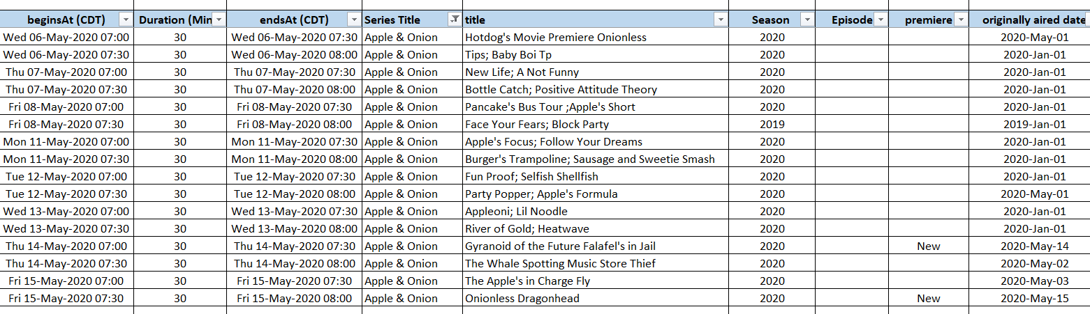

I am not seeing all being marked as new. May be updates are coming in late and closer to the airing times. Data available now shows the following
There may be combo airings (multiple episodes together) here which would complicate matters
There are a couple marked as “New” - are these wrong. They appear to have Original Air Dates that would be in line with “New” beings et
I can see that for the 3rd May airing 23:30 CDT it was marked as new. So this was the error you are referring to? I do not see any more airings after that.
The airing at 23:45 CDT for 3rd May is now showing as “New” for me - may be it was a late update.
The remaining airings are currently showing as follows with one marked “New”
Please let me know which are wrong

Both Apple & Onion “new” episodes are definitely not new.
