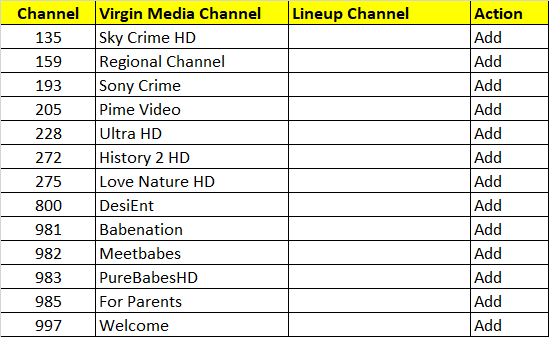

I had a look at the list of channels for the Virgin Media Scotland (Central) Digital lineup. Can you confirm that the following as being what needs to be done. Also for 102 - should it be the BBC 2 channel listing? BBC 2 Scotland closed last year - so I presume it was not switched to the national BBC 2 channel
Found a list here but I am not sure if 100% accurate
Could you tell me what you are actually receiving from Virgin for each of the channels I am listing below (when compared with my Virgin Media channels - mine do not agree with what is in the November 2019 pdf)
205, 228, 272, 273, 274, 275, 276, 277, 293, 295, 299, 315
