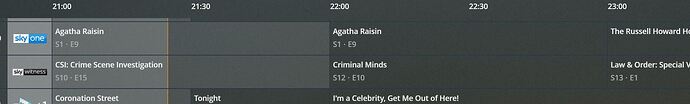

I’m a Celebrity Get me out of here on ITV at 9pm (episde 13) is not recording tonight. However it will be recording at a repeat tomorrow at 4pm. There is nothing recording at that time and anyway I have 4 tuners so unlikely anyway… I tried selecting New and Repeat to see if it would force it to record to an avail.

The Guide data looks ok - this is what we have for ITV HD channel

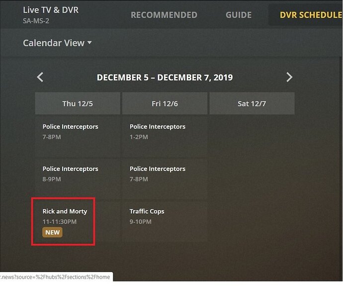

I can see that there were schedule entries for 28 November that did not match what is on the channel 4 guide and the end time being wrong for Rick & Monty. Will mention it to our provider

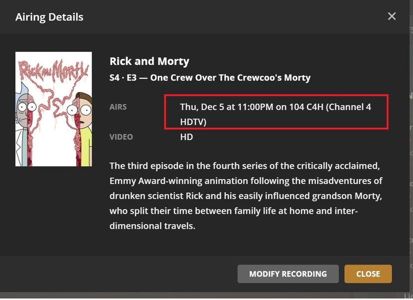

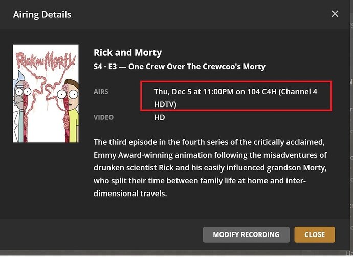

I have not been able to reproduce this. Do you record “New only” or “New and Repeats” ? I tested this for Series 4 Episode 3 which is due to aired on 4th and 5th December. I can see errors for S4 E3 where the “New” indicator is set for channel 4 airings when this series airs first on channel E4 - so only E4 should have the “new” indicator. The originally aired date appears to be wrong - inconsistent of what channel 4 web site says. But as this series is sequenced with Season and Episode numbers, the originally aired date is not used.
Screenshots showing my test for all episodes
If it happens again where the recording options are ignored, I would like to see the logs and screenshots
for logs
