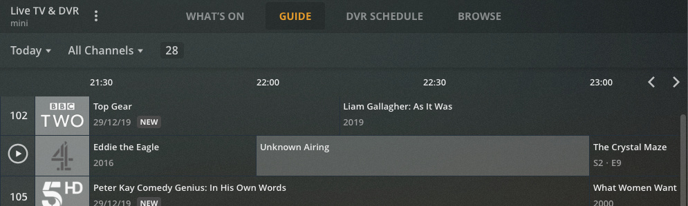

Unknown Airing on Channel 4 tonight at 22:00:
I’m tuned into Freesat South.
I tried refreshing the guide, retuning all channels, and even setting up a new Plex install on my Synology NAS but that slot still shows as Unknown Airing.
The Last Leg not scheduled to record tonight - I noticed it in time and cancelled my all recordings link to record this episode only.
