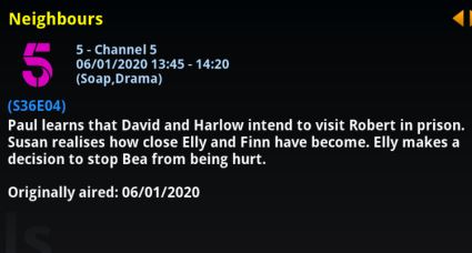

Fridays Neighbours is Episode number 8269
This is S36E03 (not S82E69)
Home and Away is also wrong on Five (005/105) at 13:15
Plex has mondays episode as S72E01, should be S32E186 and then sequential from there on
Ah OK, was just basing it on how Plex used to say S86 until last week. Fri def had the wrong airing date.
Thanks, not checked in a while, last time i looked they only had dates (though a request for proper S/E has been in for a while)
The soaps usually go from the first episode of the year as a new season (based upon original country of airing)
Luckily Neighbours premiers on the same day as OZ, so it all ties up
H&A is awkward as the UK is about 5 weeks behind, so we are still in the 2019 season
This is what should be showing for Monday
0601n
0601haa
Ah OK that makes more sense then - My 5 just a bit confusing. So only issue is wrong date for Friday’s episode.
My 5 is using the sequential episode number (dont think it’s possible to get a S/E from this, there are now 260 episodes per season)
To fully fix this we need to either, get Plex to provide the correct S/E or use the original aired date
This is 2020 episode for this year
