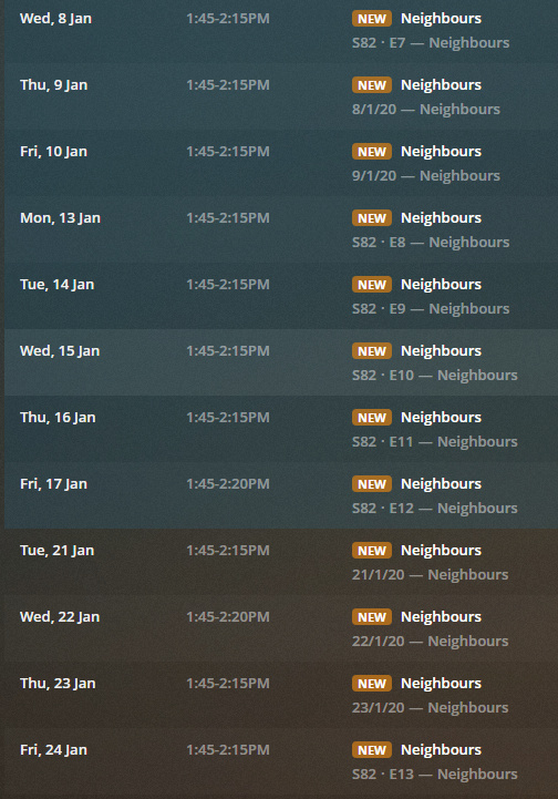

Any updates on what is happening with Neighbours and Home and Away (reported when the new guide started)
For Tomorrow
Home and Away S72E11, should be S32E196 which aired 17/10/2019
Neigbours has now lost S/E and is dated 17/01/20 should be S36E14 aired 20/01/20, anyone series recording this will probably get a fail tomorrow as it has the date of last friday
Well spotted @paulsalter - it is indeed showing up as skipping tomorrow:

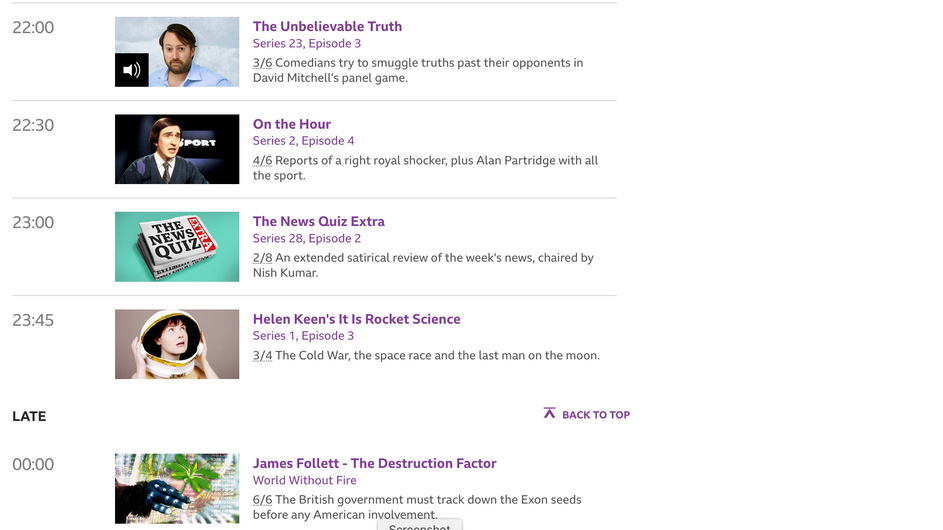

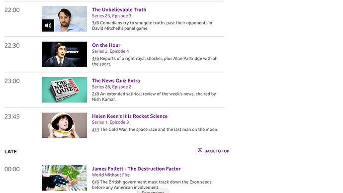

Radio 4 extra listings as slowly degrading … they are showing a lot of ‘unknown’ airings attached a screenshot for today (with the same listing from the BBC schedule). It covers 3 or 4 shows, which is an interesting error mode.
These dropouts continue until Thursday 6am, when the schedule is lost completely.

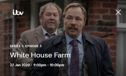

White House Farm on ITV 003/103 Freeview has last weeks episode number, if anyone has this on series record you might need to check
Tonight should be episode 3 as per Freeview website

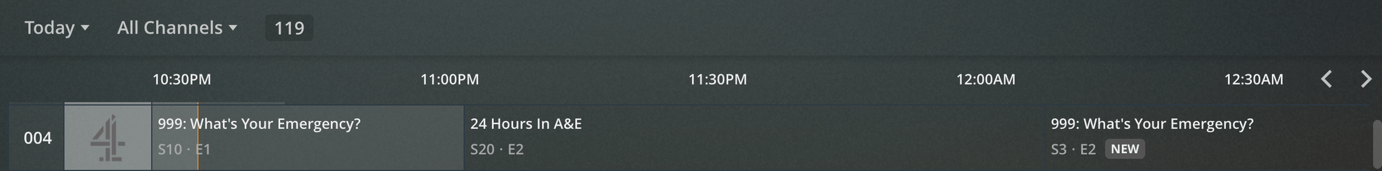

New series of 999: What’s your Emergency started on January 20th. Tonight is a repeat so is correctly not flagged as NEW, but S3.E2 apparently is!!!

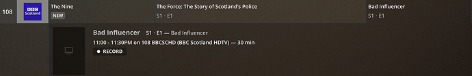

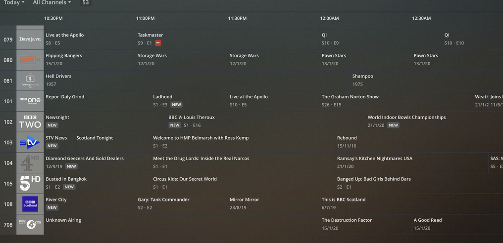

BBC scotland seems to be losing programme details - screenshot example attached for tonight (23rd Jan), with BBC version that does have the details (its the same if I click through onto the plex page for the show)
