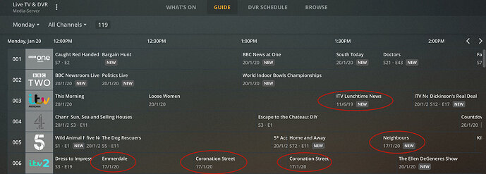

For ITV Lunchtime News showing 11 June - is a quirk of how we handle airings without the original airdate being provided. This area is being looked into and hopefully we will have a better algorithm, At the moment there is higher priority work being worked on but will revisit this in the near future
Emmerdale and Coronation Street were correct and a check on the ITV2 channel schedule and tvdb would confirm that these were 17th January airings
At this moment I am unable to determine why Neighbours episode showed as 17th January. It should have been 20th January. Let me know if you spot an error for another episode

OK I now know why and how Neighbours ended up showing 17 January date
There was an entry for Ireland which had the 17th Jan. Whilst our data is regional, we are currently not picking original dates per country - but the earliest date for the region. There is an open issue for us to improve on this

May be then our action was right - in picking the oldest original air date. I think it was in this case an error for the Irish date and it should not have been the 17th because I believe Ireland dates are a day behind UK. We will look into it as part of the open issue we have.

If Ireland is a day behind the UK on Neighbours, then i would expect Mondays episode to have a date of 17/01
Add a file to the library as âNeighbours - 2020-01-17â and match this to tvdb, you will get details of Friday 17th, which is correct
This is why original aired date (oldest) is needed, not premiered by region/country
This appears to have been a specific case where our provider had an error for the Ireland date and subsequently corrected but our ingestion process did not handle this.
The episode date for Ireland should have been 21 January and not 17th. On the 10th January or before we picked the earliest date - the 17th as the originally aired date. Our provider corrected the Ireland date on the 12 January -setting it to 21 January (a day behind UK) but we have a problem in our ingestion process where this was not handled and we remained to use the initially provided date of the 17th.
