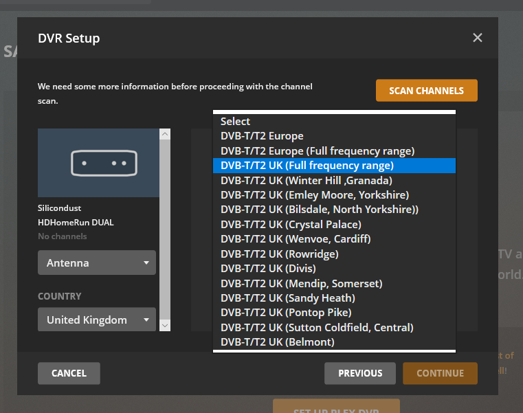

In Tvheadend, I can create my own channel lists. I’m in Cornwall (Caradogon transmitter) and lots of channels are non-standard frequencies. So I just modified an existing list of channels, using widely available Freeview channel data) and it works a treat. With Plex, there is no South West channel set, so I used the entire UK set, and don’t get any HD channels. Is there any way I can create my own channel list in Plex - or can the support people please create one for the Caradogan Hill transmitter? Otherwise, I have no option but to cancel my plex pass and go back to tvheadend.
The “DVB-T/T2 UK (Full frequency range)” scans all possible frequencies within the UK including any used by your local transmitter.
All frequencies are scanned including + and - 167 KHz offsets
We have not updated local transmitter frequencies because of the continuous change that has been taking place for 5G. Once all the changes stop, then we will look into the local transmitter scanners. But the full UK one does everything - it is slow because we have higher timeout periods
If you are referring to the scan lineups then not getting HD is to do with the tuner / transmitter since the scanning is done for the whole UK frequency range
Is this Hauppauge WinTV tuner or an old HD Homerun eg HD Homerun Dual as in the screenshot I posted. This old tuner does not handle T2 so HD channels would not be picked up.
Once you scanned the frequencies and got a set of tuner channels, then you would select the Freeview West Country OTA Broadcast guide which covers Cornwall for EPG data

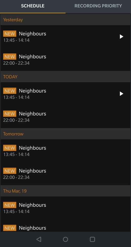

Neighbours currently has a lunchtime and evening episode all this week. All are showing up in guide, all show as new, but only the lunchtime one is recording - can this be fixed?
Let me have server logs captured soon after the end of the evening episode. I will see if it thinks it already has the episode.
