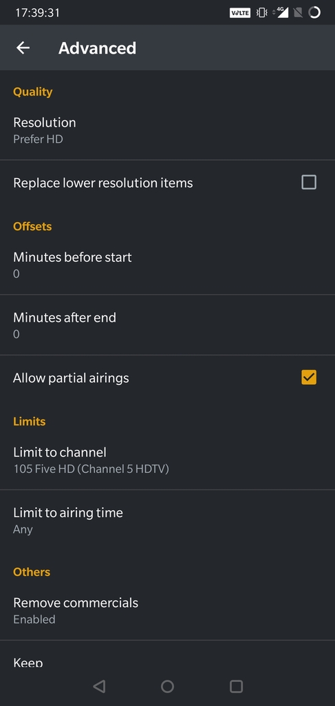

Further to my earlier reply - a quick question: are you using one of the OTA freeview lineups ? And I presume you restricted recordings to just channel 5 for this
Will try and capture logs this evening assuming it doesn’t record, although it’s only this week they have this extra episode. It’s just weird it is being picked up fine in the schedule then not recorded.
I’ve got it as New & Repeat, limited to 105 on Freeview

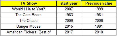

In addition to this, the repeats of “Would I Lie to You” on BBC (Friday 20th and 27th March - Series 12) and Dave (Tonight 21st March - Series 7) are listed as and recording as 1999 as opposed to 2007:
wilty
I also see from some of last year’s recordings that I have a mixture of 1999 vs 2007 in the filenames so it looks like this issue has been going on a while.
Wikipedia, The TV DB, IMDB
Both of these TV Shows are on the list. I will try and see if we can schedule those adjustments. These have been corrected by our provider but there was a problem with picking the change
We have made adjustments to the start year for the following shows. This change is live now and so an EPG refresh ought to pick the new value for the year
So recordings will now go into folders with the new “start year” value
Note for everyone in this thread - please see the above post as this change affects directories where recordings of these shows will go into
Interestingly both “Danger Mouse” and “Would I Lie to You” are already being stored in 2015 and 2007 based folders respectively - it was just the filenames that were wrong.
