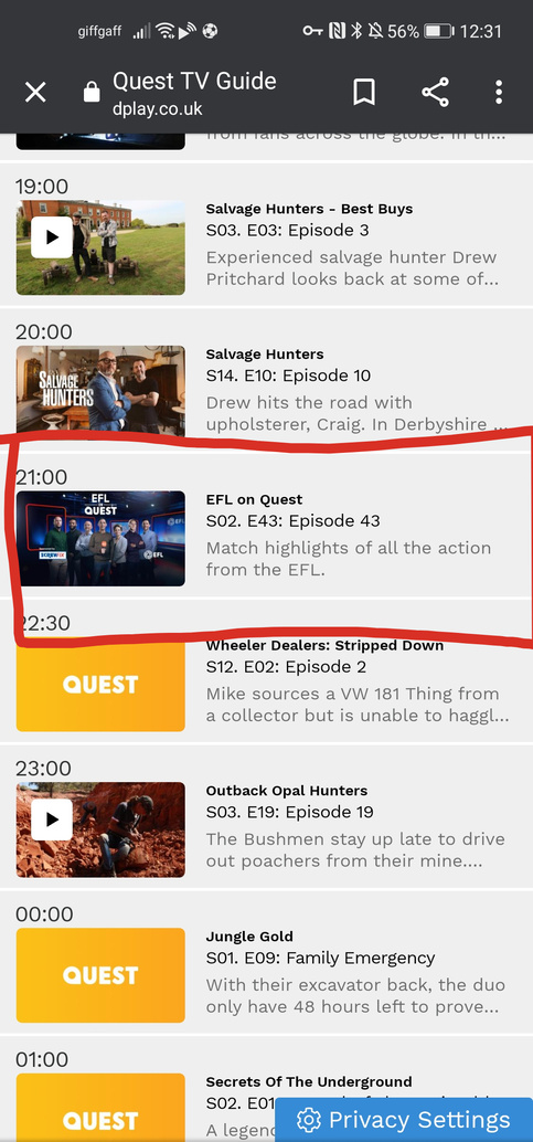

Just to confirm the Freeview OTA guide also shows it as āNew: EFL on Questā @ 21:00.
