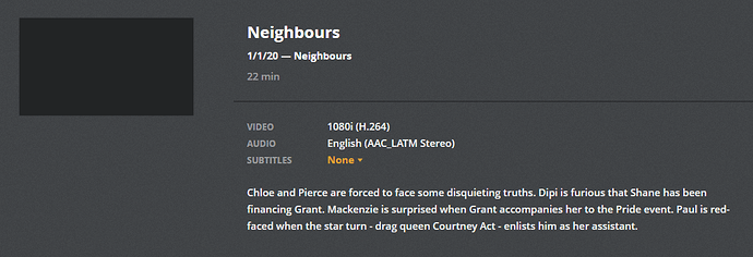

I was just about to post to say Neighbours seems to be finally sorted, and then I caught up with the mess that is Thursday and Friday’s recordings. I actually started watching them back to front at first due to the dates until I realised what had happened. We’re back to generic titles, the dates are shot to pieces again, for some reason it’s still using a random photo for characters that have never been in the show and we’re once again back to generic descriptions. @sa2000 I know you’ve raised this programme multiple times with the listings provider, what are they playing at?
Actual dates should 25/6/20 and 26/6/20 - generic info for one but not the other

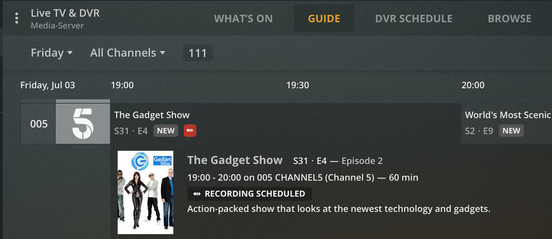

The Gadget Show on Channel 5 is showing as “S31.E4 - Episode 2”. So the episode is correct, but the description should also be Episode 4.
I have just had to go through and change previous recordings as for some reason the recordings started at S31E02 and were all out by 1. Thankfully it didn’t stop any episodes from being recorded (so far).

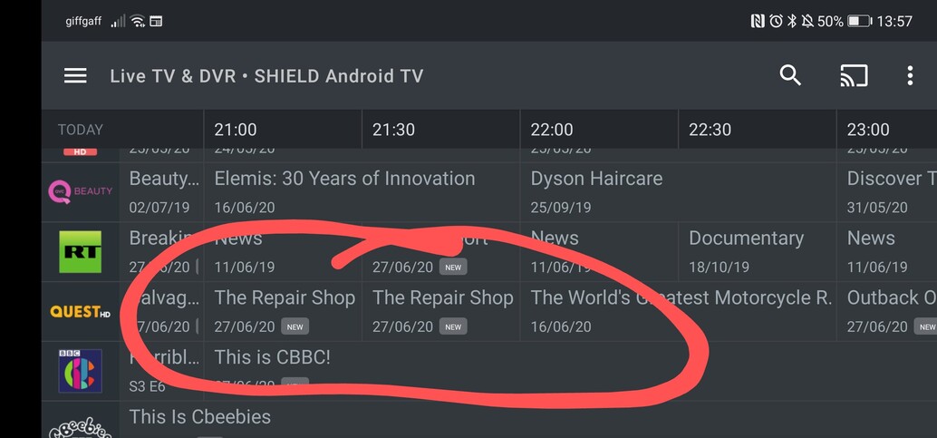

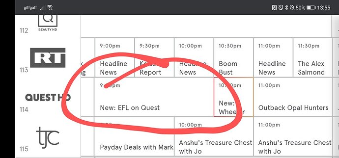

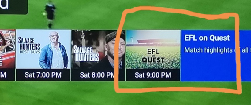

Same issue as last weekend. EFL on quest is accurate on Freeview guide and also within HDHR guide but Plex doesn’t agree. So frustrating. I’ve used Plex for 4 months now and am a big advocate but a few little niggle stop it going from good to great.

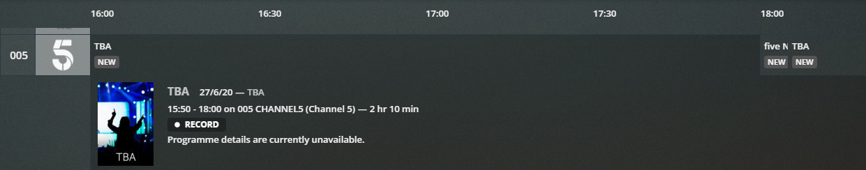

It seems there are some large chunks of TBA on 5 (Channel 005), 5 + 1 (Channel 044) and 5 HD (Channel 105) today:
I appreciate this is not going to get sorted for today but I wanted to flag it in case there is problem somewhere.
Seems to be a recurrent issue with Channel 5 family of channels - @sa2000 can you please get your provider to try and sort this out?
I’m not sure if this has been asked before…
Would it be possible for Plex to read the guide from freeview? This info seems to be correct, is updated frequently and I suspect there is an api to retrieve the data. I assume all the commercial PVRs use this. This could offer a much better solution for UK users.
I can see that 3 airings on channel 5 slipped through and did not get correctly marked as 25th June and 26th June episodes
Channel 5
25 June 17:30 BST
26 June 13:45 BST
26 June 17:30 BST
and the 5+1 and 105 HD channels
Similarly on channel 30 - 5Star
25 June 18:00 BST
26 June 15:00 BST
26 June 18:00 BST
I will flag it to our provider
At this moment after today’s data ingestion and an EPG refresh now, channel 5 appears ok for Neighbours. There are a few still to be corrected on channel 30 5Star but they are far off - 6 July and later
Our provider has a manual process and it appears that sometimes the adjustments do not get done in time or get missed
I will flag both sets to our provider
Thanks. The airings did record OK (lunchtime each day last week), it was just the way they kept switching the dates and putting generic info that was the problem this time.
I have flagged these to our provider. Appears about 2 hours or more a day
