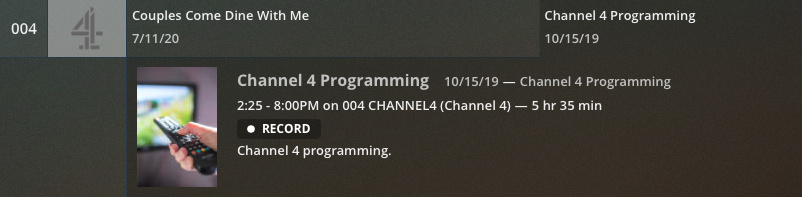

The F1 scheduling for this weekend has completely vanished as multiple hours of Channel 4 schedules have been replaced with “Channel 4 Programming” blocks - one on Sunday is almost 18 hours long (this I believe was also the case with the previous DVR set up based on the photos I took of my schedule to reconstruct from, as the F1 events had disappeared from DVR Schedule).

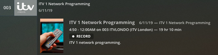

Looks like ITV is in a similar state for the weekend too, here’s Sunday:

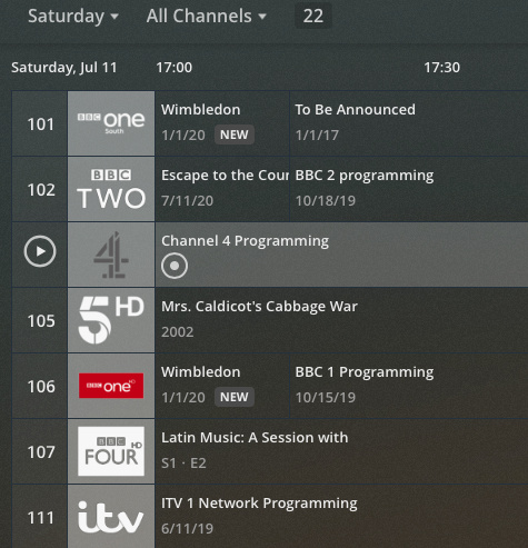

Saturday’s, um…Worse:
This persisted for both channels after performing a Guide refresh in settings.
That is not good. Thanks for bringing it to my attention. I have escalated it to our provider
