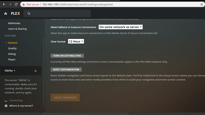

But since then the server has disappeared and I canât seem to be able to claim it again. I have followed multiple steps found on the forums regarding editing preferences.xml, but nothing helps.
What do I do now?

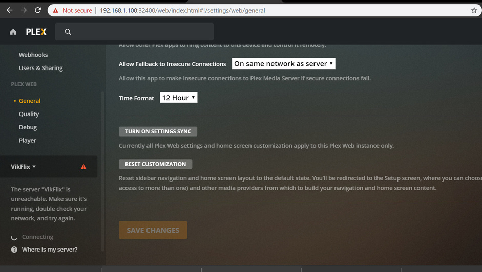

And again the server is unreachable (from the local network).
Ive spent all day with this now, and countless hours before too. I am starting to feel a bit desperate since Plex has announced that versions prior to 1.18 will no longer work when it comes to artwork.
Clearly there is something wrong / not compatible with these versions of Plex and the QNAP NAS that I am on.

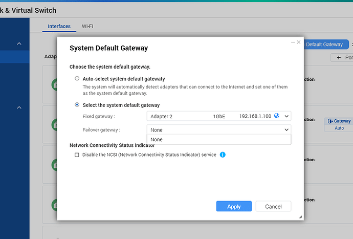

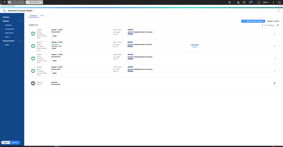

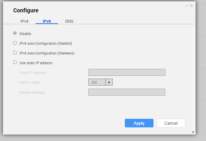

Check your DNS settings on the QNAP, as well as default gateway
You have your QNAP as the default gateway towards the internet, AFAICT
It should be your router, and most likely on 192.168.1.1 or 192.168.1.254
I canât really specify anything other than failover gateway.
I changed it to âdefaultâ but that didnt help. See pictures for options.

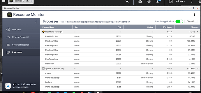

Recently instead of 99% CPU, its taking 99% RAM instead.
I had the same issues a few months back, before I decided to downgrade to 1.17.
Been without Plex for 3 days now, so hope someone can take a look at this, or I will need to downgrade again.
These images are shortly after reboot.
