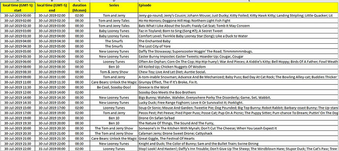

I have checked the schedule for Boomerang. I need specifics to look for. Like at this time it is showing this and it should be this and that you have already completed a full epg refresh before reporting the problem
This is 31 July schedule from the EPG with times adjusted for your timezone (GMT-5)
I am not able to access the Boomerang US web site from the UK - restricted to US only - but i found this schedule which appears to agree with the EPG - with time zone adjusted to Central
and this is the EPG data for 30 July. Please tell me exactly what was wrong. Hopefully i got time convesions right

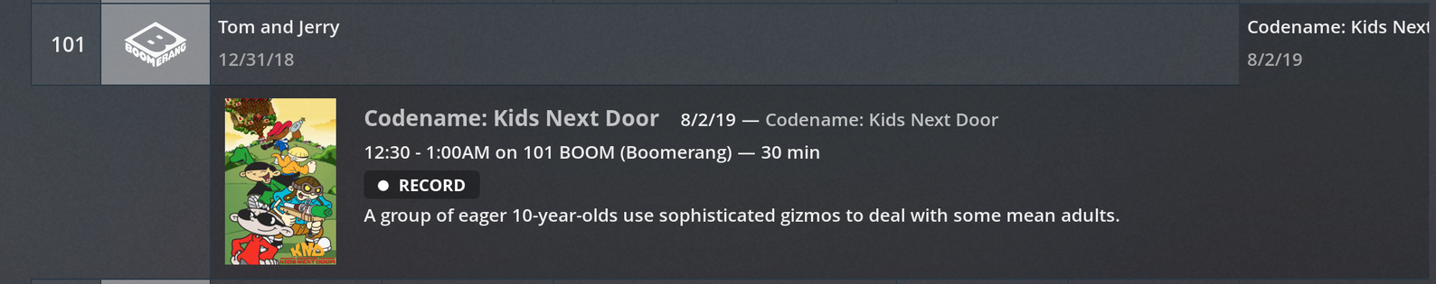

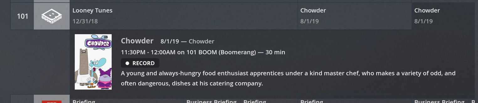

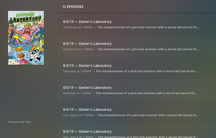

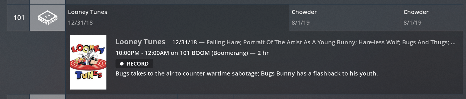

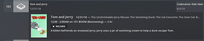

Ok, I just did a full refresh to see if there was still issues. It turns out this is a different problem altogether than I imagined. This is some stale cache issue.
I’m including a set of pictures to detail this issue. Essentially there is duplicate listings overlapping with other showings. The correct show is listed on the grid guide, somewhat, but you can tell there’s issues by looking at all the channels shows and looking at their future air dates. The duplicate shows do not always show up in the gride guide, but I’ve included examples of that.
Thanks - yes i found that after i pasted what it should have looked like. When program data is being updated - sometimes the old entries are not removed resulting in overlapping data. I have raised this with our team to address and resolve

I see one episode of The Jellies on Cartoon Network with wrong year. “Pilot” to be aired 16th August midnight ET and 04:30 am ET. If you see more, please do a full manual EPG refresh and see if it changes.
I do see episode numbers being wrong and I will refer this and the one error on that episode to our provider
This shows the airings over next few days for “The Jellies”. Except for that episode, the others are correct as being 2019 since Season 2 is 2019 and 2017 being for season 1
