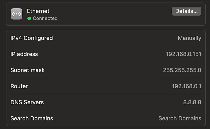

On Ethernet system preferences, set ‘Configure IPv4’ to ‘Manually’ then set it to:
IP: 192.168.0.151
Subnet: 255.255.255.0
Router 192.168.0.1
DNS: 8.8.8.8
Then press ok apply etc and quit preferences and try again.

Okay, I gave it a shot and it didn’t work. Interestingly enough, with it set on DHCP, it shows a green light indicating I have access to the internet, even when I don’t. It shows this both on DHCP and when I set it up manually with the settings you gave me above:
