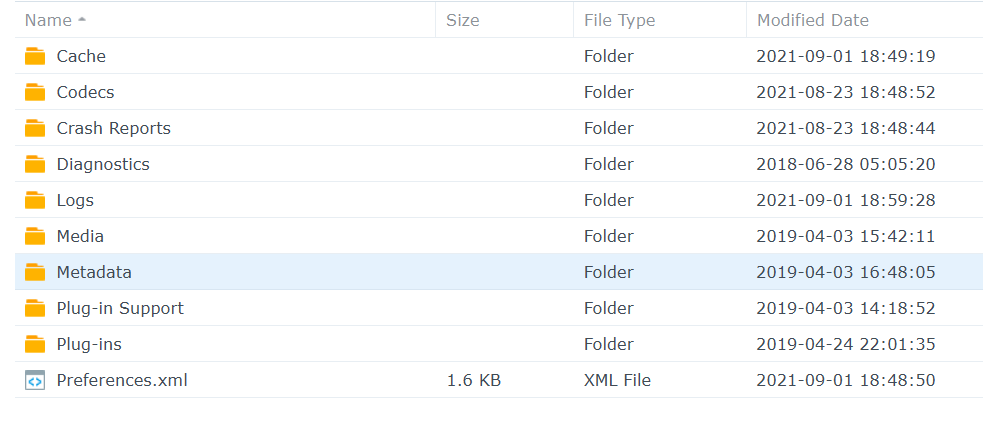

In the Plex share folder it indicates it takes up 24.99GB with 90601 files and 93723 folders. So it appears all the data is there. When I go into Plex/Library/Application Support/Plex Media Server it appears most things are there. When I browse the sub folders there is a lot of data. Application support under Library just has the Plex Media Server in it with its data. My actual media is in separate share folders on the nas with permissions adjusted per the guide.
To answer your second part, after I ran Plex (DSM7) version the first time it did a set-up routine. I thought it was just confirming things. My account and user information was all there from the prior install but not the media or the “old version” of my server. that is when I noticed the second server which is able to access my media etc on the nas.
Plex Media Server folder:
Please let me know if you need anything more.
Thanks!

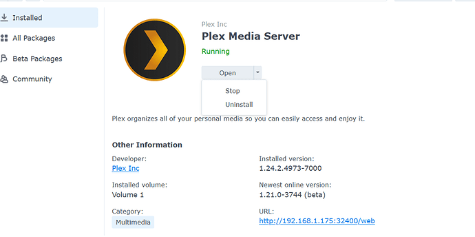

The blue title bar in the GUI should say “Install” .
If it says “Update” or “Upgrade” – screenshot – stop – and show me please.
Else, follow it through.

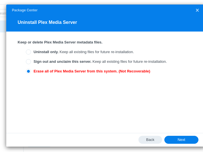

Stupid question but where is the erase option? I am not seeing it.
It all sounds good.
I suspect you were caught by a split-install like another user was.
I don’t know what is prompting DSM 7 to do this because I can’t reproduce it.
Regardless, with the data known good, let’s proceed.
Can you clarify where the erase option is? I just see the uninstall. Google failed me or I failed it.
Which language are you using? I support 8 DSM languages in the package
Yes… Go to Uninstall.
On the next page you will see the uninstall options. (new in DSM 7)

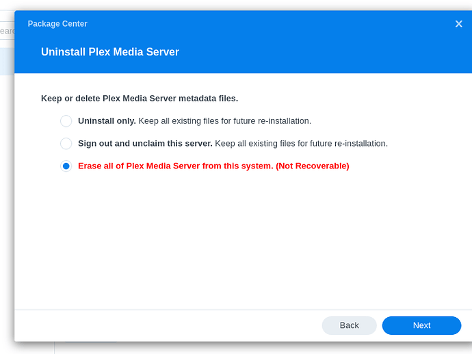

Uninstall the DSM 7 package – choose the ERASE option to get rid of the errant server DSM 7 created.
