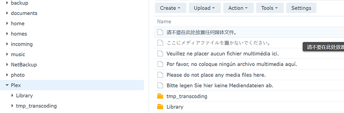

Please bear with me, since I don’t see what you see. To me this indicates, which is also what I have setup, that I only have one plex share on a single standard volume1, and everything should be as preferred for migrations to happen, right? I only have one volume on this DSM, no external drives.
admin@Server:/$ ls -la /volume*/plex
total 0
drwxrwxrwx+ 1 root root 656 Dec 7 2020 .
drwxr-xr-x 1 root root 560 Jul 15 00:13 …
-rwxrwxrwx+ 1 plex users 0 Apr 17 09:18 ‘Bitte legen Sie hier keine Mediendateien ab.’
drwxrwxrwx+ 1 plex users 8 Jul 14 23:54 @eaDir
drwxrwxrwx+ 1 plex users 38 Dec 7 2020 Library
-rwxrwxrwx+ 1 plex users 0 Apr 17 09:18 ‘Please do not place any media files here.’
-rwxrwxrwx+ 1 plex users 0 Apr 17 09:18 ‘Por favor, no coloque ningún archivo multimedia aquí.’
drwxrwxrwx+ 1 plex users 1456 Jul 14 18:59 tmp_transcoding
-rwxrwxrwx+ 1 plex users 0 Apr 17 09:18 ‘Veuillez ne placer aucun fichier multimédia ici.’
-rwxrwxrwx+ 1 plex users 0 Apr 17 09:18 ここにメディアファイルを置かないでください。
-rwxrwxrwx+ 1 plex users 0 Apr 17 09:18 请不要在此处放置任何媒体文件。
admin@Server:/$ ls -la /volume*/Plex
ls: cannot access ‘/volume*/Plex’: No such file or directory
admin@Server:/$ echo /volume?/*ex
/volume1/plex
@ChuckPa I guess I have to make a clean install then, since upgrade obviously does not work for me for some reason. :frowning:
