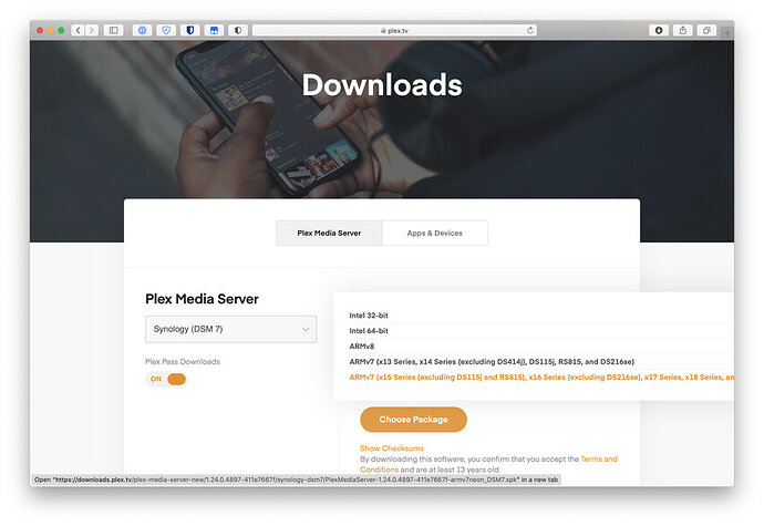

I’d like some help with my situation. I am attempting a clean install on a DS-1821+, but it is failing. Here are the steps I have made:
  • Uninstalled Plex manually with the erase option.
  • Deleted the Plex share.
  • Restarted DSM 7.
  • Attempted install of PlexMediaServer-1.24.0.4897-411e7667f-armv7neon_DSM7.spk
DSM 7 reports the package is unsupported.
Please advise how best to proceed. Cheers.

You have the wrong package.
Per: DS1821+ | Synology Incorporated
You need the 64-bit Intel package

Thanks Chuck. If that is the case, you should update your website, as it is offering the wrong file:

Yes, right there…
2nd line - Intel 64-bit (AMD makes X86_64 CPUs. They don’t make ARM CPUs)
Although, the bottom line shows x18 series, hence my confusion. It is a x21 series!
64-bit intel is working.
Thanks for your assistance.

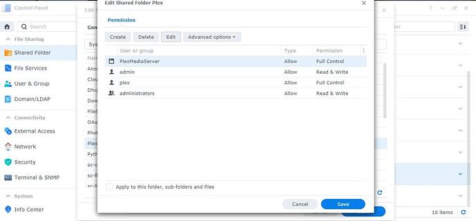

You missed a step in setting the permissions with the “CUSTOM” permissions settings.
Since you can’t interrupt it. Restart DSM
hmmmm… but i checked its already on full control
@robbyong
right there…
Before you start this again…
Apply to this folder, sub-folders, and files
Let it do the work now.
When this is done, Installation & migration will be very quick.

yep. i also checked that. the apply to sub folders
