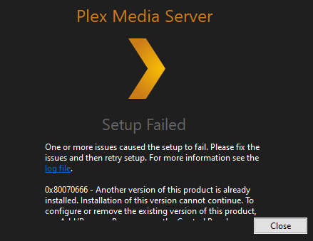

edit ~Sorry I missed the step of uninstalling first. Honestly I’m nervous about doing so. Will I lose any of my settings or viewed/unviewed data if I uninstall?
Tried a rollback of server versions and got this error.
