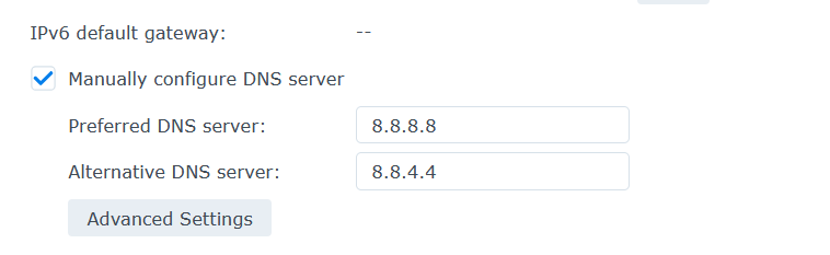

Found a post about using 8.8.8.8 and 8.8.4.4 for the
