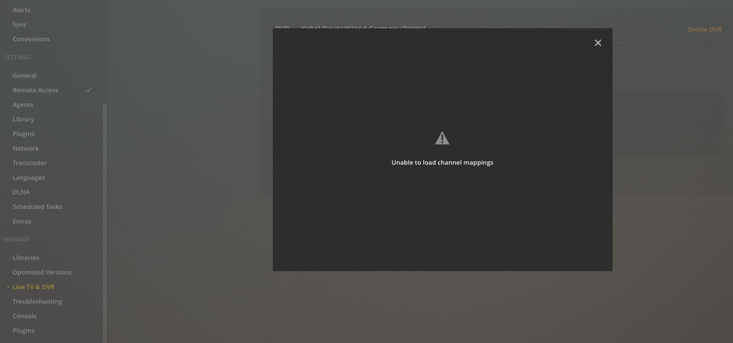

Really annoying.
This is the third time this has happened to me over the last few months.
The only cure seems to be to delete and re-add the DVR. Which sucks because the channel mapping process is a nightmare in plex. Really. It sucks. It takes me about 30-60 minutes to manually re-map all the channels between the HDHR and the EPG channels to be correct.
According to the logs it looks like this is because of a root cause…
HTTP 404 response from GET https://epg.provider.plex.tv/lineups/5cfe43ef6c5d3e001db2c128/channels?X-Plex-Api-Token=xxxxxxxxxxxxxxxxxxxx
Perhaps when I setup the DVR and select a cable provider everything is fine…then maybe plex is changing the cable providers/mappings on the server and so the provider in my plex DVR config no longer exists and I get a 404? Just taking a stab at what might be happening.
In any case the 404 is coming from plex’s epg service and that appears to be the root of the problem. Can be fixed by plex epg service not returning a 404 or the plex app updating/migrating my DVR config to point to the new provider if they want to change things on the epg service. However the error is between the plex server software and the plex.tv epg api…HDHR isn’t really involved here…so I think this is up to plex to fix.

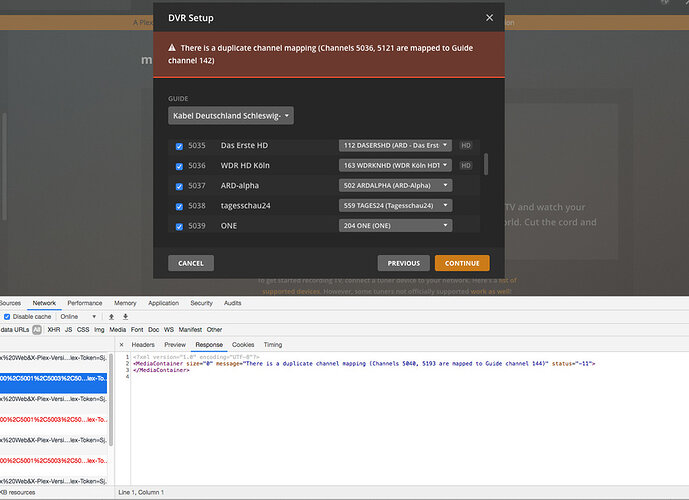

A little feedback for your product team:
It is really crappy user experience to have plex EPG updates break my existing DVR setup (multiple times now). I get no warning and just eventually discover a bunch of my recurring/scheduled recordings are missing because the EPG went away. Then I have to delete and re-add the DVR, and remap all the channels to some new updated/improved EPG data source.
Instead of making your users do this work over and over, you should have some type of migration in place when changing EPGs. If it is impossible to migrate, then you should notify your users that you are going to break them and then and try to only do it once. That breaking change that requires users to re-setup their DVRs and EPG mappings should include provisions to support plex handling the migrations in the future.

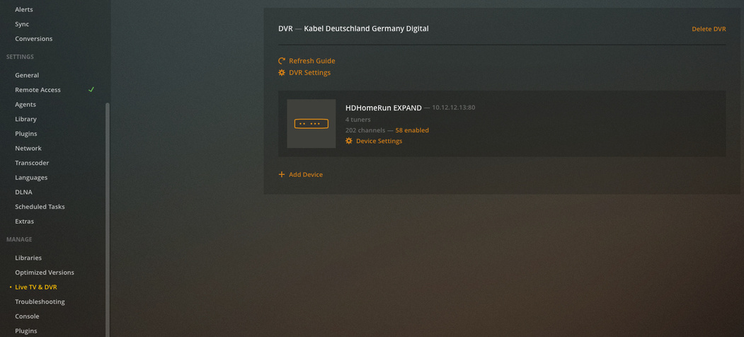

So I deleted and re-added the DVR.
Maybe the guide data has improved but the DVR channel mapping is just as much a nightmare as EVER.

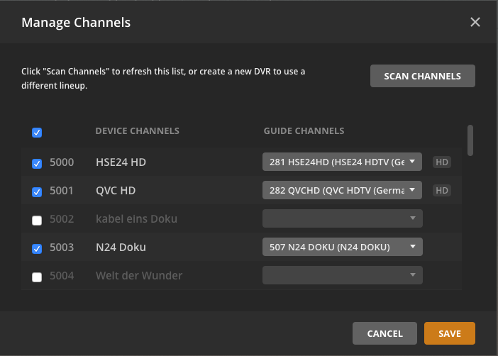

  • The out of the box mappings are only about half done. Many HD channels are not mapped.
  • The channel dropdowns aren’t sorted alphabetically but by some channel number that doesn’t have any practical purpose because it doesn’t relate to the channel numbers on the HDHR. So you have to scroll through a dropdown of hundreds of channel names that aren’t alphabetized to try to find the right channel.
  • If you map the same channel twice (ie because you map the guide info for a channel to both the HD and SD versions of the channel) you get an error: There is a duplicate channel mapping (Channels 5036, 5121 are mapped to Guide channel 142) and then you need to go find all those and try to remap them (find a second guide entry for the HD channel).
  • There are a ton of small things that would make this much better. In the past I have even resorted to user scripts to try and fix the usability of this TERRIBLE plex interface.
Plex really needs to have a couple UX people look at this interface.
And I stand by my comments from earlier that it is REALLY crappy to break this for users without warning and make them redo a huge amount of manual work every few months. Come on.

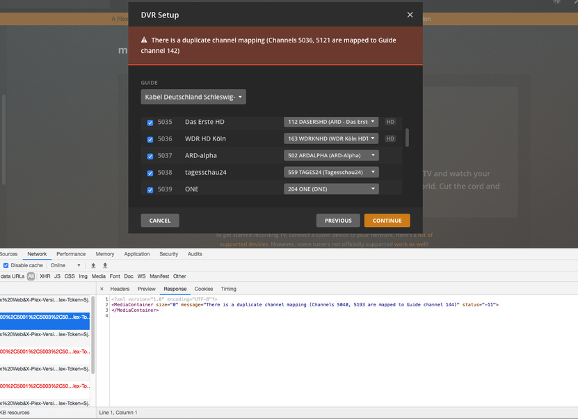

… even more awesome… that error (There is a duplicate channel mapping (Channels 5036, 5121 are mapped to Guide channel 142))… even when I fix it (see screenshot) the error persists and I can no longer hit continue (button doesn’t do anything). SO I would need to cancel the DVR window and start over with all the mappings from scratch. I cannot believe how broken this is.
Inspecting in chrome dev tools I see a bunch of 500 errors about other duplicate channel mappings. Unfortunately the UI doesn’t update to show the new message. Any users without dev tools will be stuck starting their mappings over from scratch.
“There is a duplicate channel mapping (Channels 5040, 5193 are mapped to Guide channel 144)”

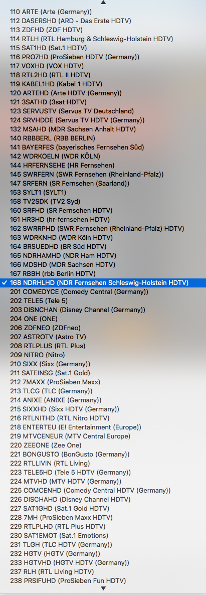

40 tuner channels I care about.
About 800 channels in the EPG drop-down. Not in alphabetical order, not searchable.
40*800 = 32000 channels I have to visual scan through in order to complete the 40 mappings…every time plex does a breaking EPG update.

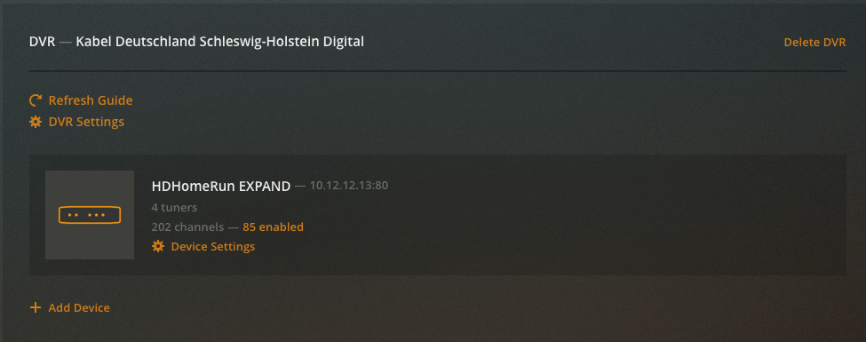

Hi.
  1. I selected Kabel Deutschland Schleswig-Holstein Digital.
The HDHomerun Expand has channels in the 5000 range.
The EPG has channels in the 101-997 range. It isn’t really 800 channels as there are many gaps…(311 channels).
I stand by my opinion that the usability of the mapping tool is terrible and buggy…and that plex should be managing the EPG migrations and not silently breaking the DVR for users. I am happy to provide data that can help you improve this tool.
The automated/default mappings out of the box are not anywhere close to good enough to excuse such bad usability in the manual mapping tool.

Going to that page, they don’t let me put in a post code but putting in my city (Wedel) I get the following:
ausgewähltes Netz: Elmshorn (ändern)
Versorgungsgebiet: Appen, Barmstedt, Bokholt-Hanredder, Borstel-Hohenraden, Bönningstedt, Ellerbek (außer Ellerbek [Holsteiner Chaussee]), Elmshorn, Glückstadt, Groß Nordende, Halstenbek, Heidgraben, Heist, Holm bei Pinneberg, Horst in Holstein, Kiebitzreihe, Klein Nordende, Kummerfeld, Kölln-Reisiek, Moorrege, Pinneberg, Prisdorf, Raa-Besenbek, Rellingen, Schenefeld bei Pinneberg, Tangstedt bei Pinneberg, Tornesch, Uetersen, Wedel
Kopfstation(en): Elmshorn 10, Pinneberg 10
Ausbaustatus: ausgebaut (862 MHz)
So I see that the channel numbering in the plex EPG does correspond to what I see on that kdg help site. I suppose if the HDHR had the same channel numbering it would be easy to map everything together. Not sure exactly how the HDHR picks its channel numbers but it is running the latest firmware (201906 something) and I did a rescan last time I had plex silently kill the DVR which was in the last few months.
The subject of channels in 5000 range was discussed here https://forum.silicondust.com/forum/viewtopic.php?t=72479
This is the first google search hit I read - there may be more.
So I guess this is a question for you to make to silicon dust and Kabel Deutschland provider
With regards to the manual mapping interface not being very user friendly - well this is not intended to be the way a DVR is setup. The design is that we auto map channels and where there are issues, we raise these issues and try to resolve - like what was done by creating 200 Kabel Deutschland lineups and if there are still errors there - we correct these.
I suspect that auto mapping of channels would be the case for 99,9+% of users and if any manual mapping is needed it would be for minor tweaks of a few channels rather than whole set of channels .
From the link you sent (https://forum.silicondust.com/forum/viewtopic.php?t=72479)
happens quite often with clear qam cable, in some other countries they don’t use such channel number thus all are in the 5000s
So what the poster there is saying is that with clear QAM cable and in many countries they don’t use/broadcast virtual channel numbers and so all the channels are in the 5000s. To me this means it doesn’t have to do with HDHR but has to do with the data available to the HDHR on the cable signal.
This wikipedia article says the same thing. Virtual channel - Wikipedia
In other parts of the world, such as Europe, virtual channels are rarely used or needed, as TV stations there identify themselves by name, not by RF channel or callsign
Based on how a normal cable box works…I figure there must be some additional data on the cable line…for instance guide data. I would guess that guide data is connected to the frequency mapping of the different channels so a user can view the guide and tune selected channels…effectively creating a channel map. However I don’t know anything about the DVB-C spec, so I don’t know if HDHR could access this guide data on the wire or not and I don’t know if it would help as it may only include channel names/order…not the underlying program IDs that Plex is using in their EPGs. I do know that as far as I can tell HDHR doesn’t do anything to present guide data…if they did that would sure make things easier right (just use the EPG direct from the cable provider).
So without this and without virtual channels…it seems that the plex idea of automated EPG mapping is not going to work outside the US?
If auto-mapping worked 99.9% of the time, I agree it wouldn’t make sense to invest at all in the UX of the mapping tool. The fact the error messages don’t update and the user has to look in browser dev tools to see which channel mapping was duplicated…or close the window and start over…is a prime example of the interface not being well tested.
Perhaps somehow I am just a crazy outlier…but I figured with KabelDeutschland and the HDHR that would be a pretty standard setup. Hard to imagine I am in the 0.01% especially given this has always been a problem through multiple firmware updates and channel rescans.
I also think that the fact plex is breaking the DVR (the 404 on the guide) without any warning or alert to the user is really crappy. Even if automapping worked perfectly, the DVR gets silently broken due to plex updating EPGs on the server and has to be deleted and recreated. So it isn’t just the channel mapping that has lousy usability here…it is multiple things around the DVR/EPG management.
Do you have many users in Germany with HDHR? I would figure you would given the investment you seem to making with various EPGs. Or is HDHR the wrong/bad hardware to use with plex and most German users are using something else? Would be happy for a tip if there is something that works much better.
It sounds to me like these 5000 channels mappings are going to happen anywhere that the cable providers don’t do virtual channels. it sounds like that is very common outside the US and on clear QAM cable. So in those cases your automated channel mapping won’t work.

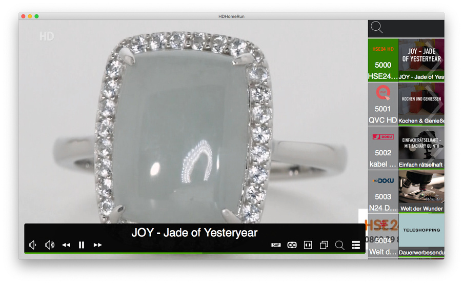

What I see (screenshot below) is that the HDHR does pull down channel names and some program information (for instance title of current program). But perhaps information about program numbers (i.e. the numbering Plex uses in the EPG that is also shown on the KDG support site linked above) is not included/passed in the “NIT”?
Do you happen to know if it is normal for DVB-C HDHR to tune all channels to the 5000 range?
Do you know if DVB-C “NIT” includes “program numbers” on the wire (that could potentially be used by HDHR to make mapping to EPG data easier in the future)?
Thanks for your expertise!
It does seem like HDHR has an easier time mapping channels to EPG data for their own guide and DVR offerings.

With regards to Kabel Deutschland lineups for your post code in Wedel, I see that Hamburg is only 20 km away whereas Schleswig-Holstein is about 100km
Any reason why you are not selecting lineup Kabel Deutschland Hamburg Digital instead of Kabel Deutschland Schleswig-Holstein Digital ?
Schleswig-Holstein is a state. Hamburg is a state (bundesland) and a city. As I live in SH that is what I selected. My city (Wedel) is indeed close to the border with Hamburg. An analogy would be selecting Washington State if you lived in Portland because you are closer to Washington state than Salem (capital city of Oregon).
That said, my issue isn’t with guide data but with the EPG-DVR mapping process…and the DVR setup being silently broken by EPG updates on the server (the 404 issue).
It’s of course possible if I get this MUCH bigger issue resolved that there might be issues with guide data…but important things first.

Yeah I already listed the HDHR channels with the EPG channels above. The question was more for NDInnovations because they seem to know more about the DVB and QAM wire protocols… the question was about whether the program NUMBERS (in particular since as I understand you that is the problem here) are even available via “NIT” on DVB-C…or if it is just channel name and program/guide info.

I don’t know what your problem with your channel numbers is anyway. Just map the corresponding one’s together manually, takes 10 mins if done for the first time, you become quicker when doing it again :wink:
My Kabel Deutschland signal coming through xteve and my enigma 2 set top box, there also the channels numbers are different but that is “my bad” because I use an exotic setup (just like you?).
So again, just map them manually and enjoy.
Yeah for whatever reason it isn’t that fast to do it manually. I explained the bugs and UX problems that make this painful above. The most annoying thing is that the DVR is silently broken without warning due to EPG updates.
If I only had to map it once I wouldn’t care…but plex has broken the DVR at least 3 times now where I had to delete and re-setup due to plex EPG changes.
