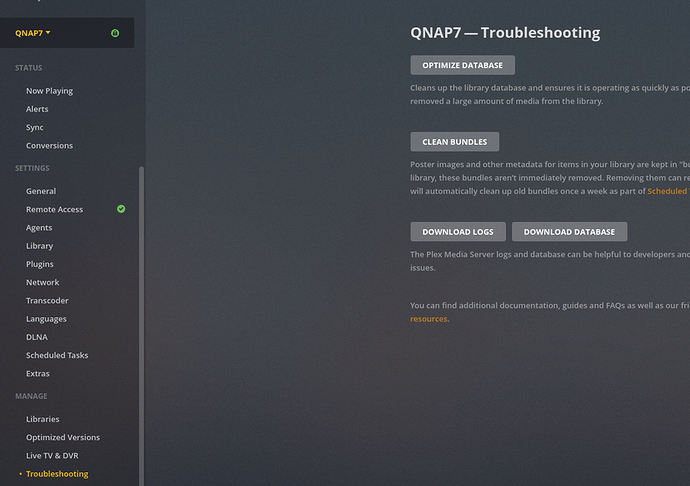

I do have an access to setting on PMS, can you take me through how to download it ?
Sorry, mixed up with another thread :wink:
Look here:

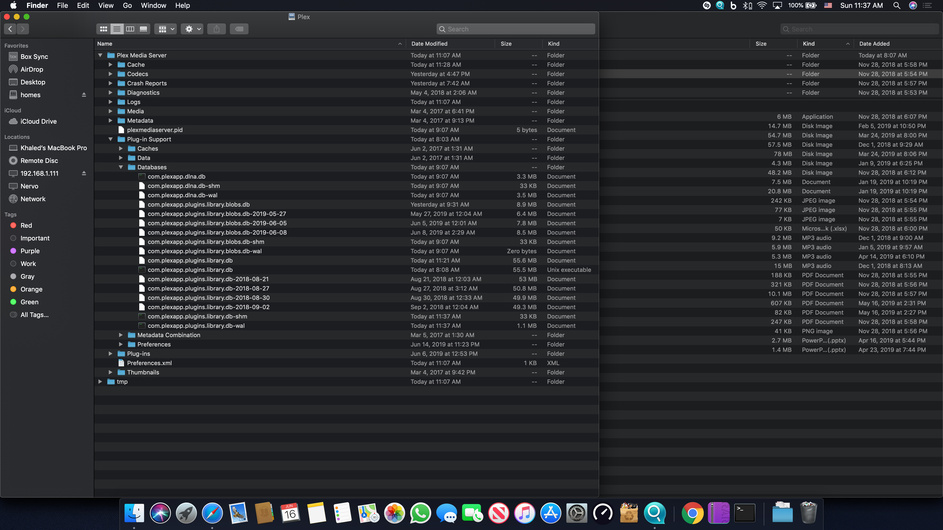

Just let me clarify what I did;
I made a copy from the corrupted database alongside with _shm and _wal after moving them out from the database folder under Plex Media Server as you can see in screen attached;
And then rename it as per the instruction and run Plex service again, I feel like what I did was wrong ?:sweat_smile:

You now have two files named com.plexapp.plugins.library.db ?
Try this:
  1. Power down PMS
  2. Make a copy of the following files:
    com.plexapp.plugins.library.db, com.plexapp.plugins.library.db-shm, com.plexapp.plugins.library.db-wal
  3. Move the backup files away from PMS folder structure
  4. Delete the original 3 files
  5. Make a copy of the file named: com.plexapp.plugins.library.db-2018-09-02
  6. Rename that copy to com.plexapp.plugins.library.db
  7. start PMS again

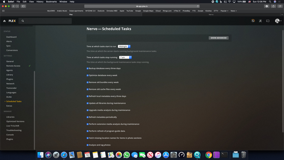

I also checked the scheduled job for backups and it’s enabled already but don’t know why the backup is so old, check the below screen;

Uncheck it, restart PMS, check it again…
Wait 4 days, and check if backup’s are been made again.
Most likely, it was failing due to a bad database

Is the scheduled backup working again?
