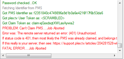

So i removed the share from my friend, updated the FW on my QNAP, rebooted, put the latest version of PMS on QNAP, rebooted. At that point the looking for server just kept spinning. So, I ran ClaimIT and now I’m stuck at this: image
That indicates that your QNAP is already claimed…
You need to look in your Preferences.xml file then to see to whom it’s claimed towards

so i ran the shell script as instructed on the qnap via putty and it all came back fine. It asked me to close the browser and reopen to http://127.0.0.1:32400. Well being that my server is not actually at that address it wouldnt work. so i substituted my address for the 127 address and I have the same problem. So, I ran the script again and got this:
I also tried rebooting the QNAP. Then stopping and starting the PMS. Unfortunately, I still cant find the PMS server on my QNAP and attach it to my account. Still get the endless ā€œLooking for serversā€ spinner.

ran bash script using new IP address on QNAP. Fail, status 401
ran bash script using IP address 127.0.0.1. Fail, status 401
