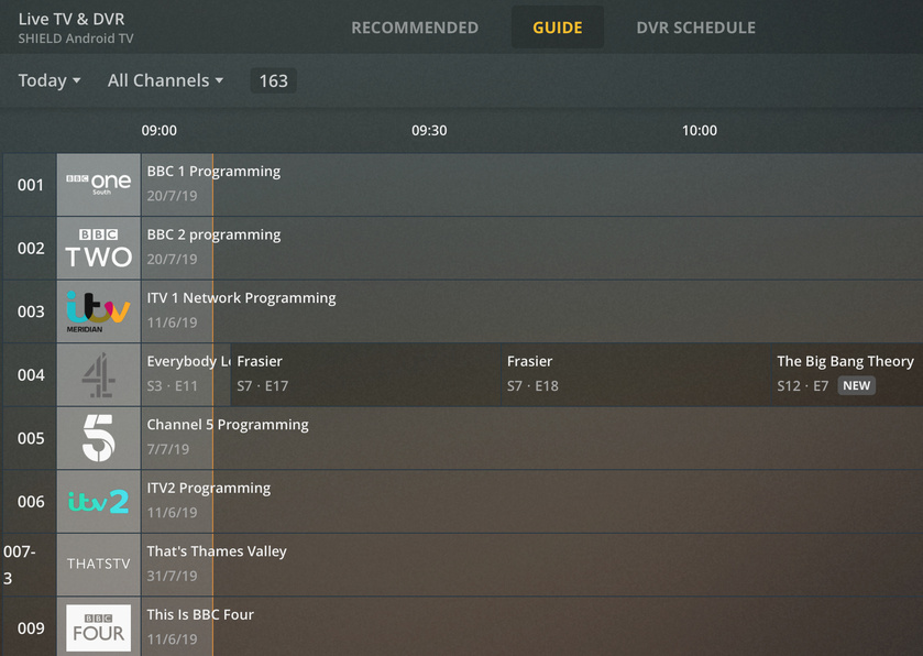

  5. EPG shows many channels with old dates and general weirdness:
    I’ve tried different EPG source providers from the list but generally speaking, the results are similar: not one produces a correct current set of EPG data.

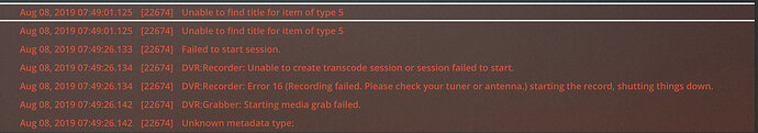

  6. Not a single channel can be played:
    It’s the same if used with an iOS Plex player or Android TV based player (Shield and Amazon Fire TV).
    I would be hugely grateful if you could help determine the problem. Note I upgraded my Shield to Android 8 last week. Not sure if this is part of the problem.
    Many thanks.Plex Media Server Logs_2019-08-07_08-47-52.zip (1.5 MB)

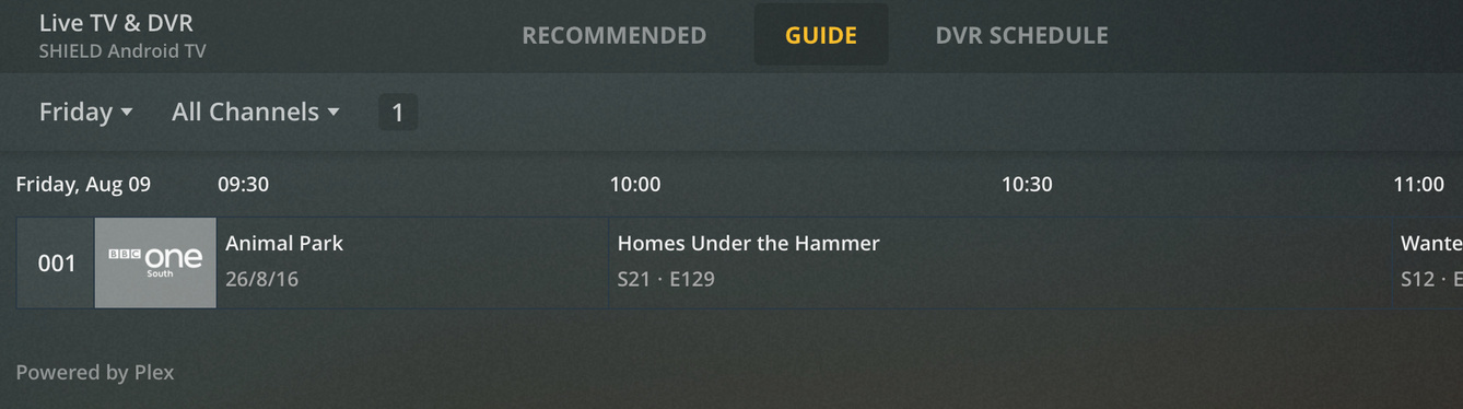

Thanks @jester_tenet There is (may be) more to this, because if I remove all channels and leave just one (in my case BBC1), the EPG still shows two channels - confusingly 101, even though only 001 is enabled:
If I select anther day, it correctly shows just 001 and on some days shows the right programmes:
If I go back to today, 001 and 101 show up again.

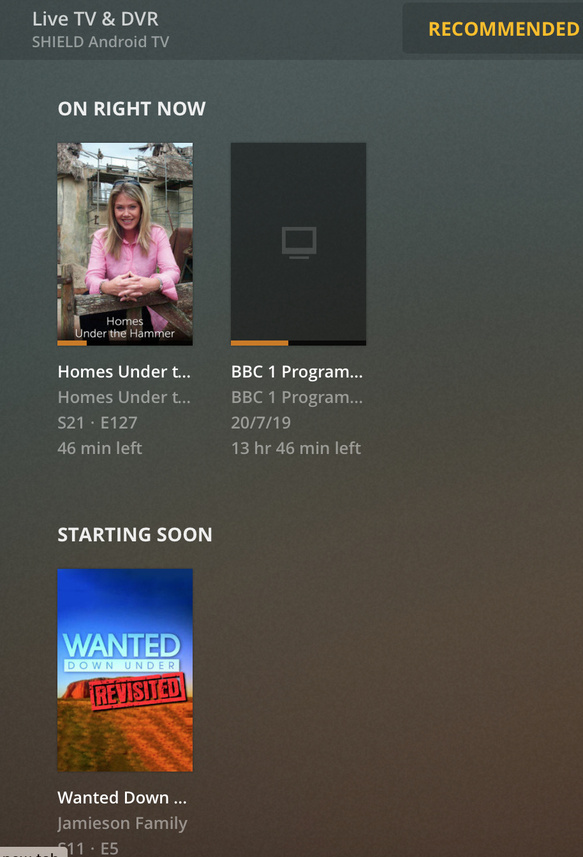

In the recommended section, it correctly (sort of) shows what is happening now:
If I click on one of these programmes and then click on the category, it shows a bunch of programmes that relate to that category.
This implies the data is there but for some reason Plex is not making proper sense of it… I should add things were working ok post 1st July.
I’ve just tried playing the current programme, whilst it does not play, it removes the fake 101 channel from the guide. The current programme under recommended correctly shows the right channel:
But it’s not appearing on the EPG:

This issue was fixed a few hours ago. A full manual refresh of the guide should correct the data
Thank you very much @sa2000. The EPG does indeed look ok now. Next problem is no channels will display, and this is a completely new install. This is captured in the logs I uploaded above but this summarises what I am seeing:
Thoughts, suggested most appreciated.
UPDATE 09/08: It’s working now. Not sure if related but originally I had no libraries. This evening added a home video library, then later in the evening I tried Live TV and it’s working across all channels. Fingers crossed it will stay this way.
