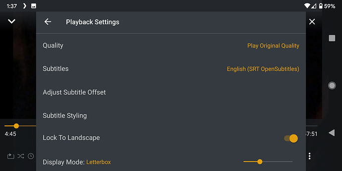

AFAIK this is not a Plex Pass feature. I’ve Plex client v7.31.0 on Pixel 3a XL / Android 10.
Buried a few levels deep.
During playback:
  1. tap the screen to pull up on-screen controls.
  2. select vertical ellipsis in lower right corner
  3. select Playback Settings
  4. select Adjust Subtitle Offset

I’m on Android 9 and have a slightly lower version number (but latest version):
I see:
Yes. Just noticed same and updated my post.
Ah! Thanks, so it is there, but (maybe incorrectly) requires a plex pass
