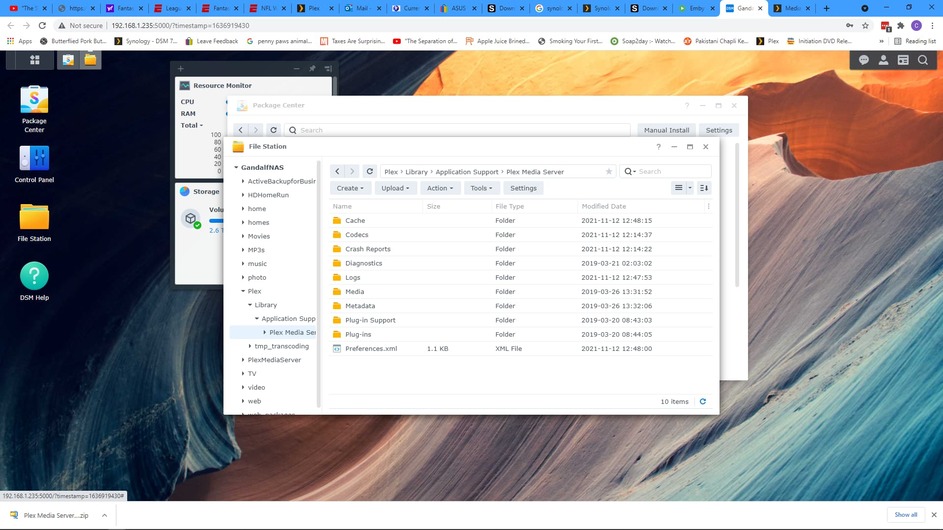

Let’s make sure your Plex server info is where it should be
- “Plex” shared folder - “Plex/Library/Application Support/Plex Media Server” exists
- Package Center
- Uninstall the Plex app - with the Erase option (to remove the Plex DSM 7 installation)
- Reinstall the app,

Ok, Perfect. TY. I’ll update later, have to work now. At least I understand a next step(s). I’ll be back and give you results in a day or so. Here is the path you asked about.
