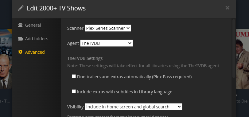

I get the same issue all the time… I edit my TV Show section and change the scanner to TVDB and then rescan it and then change it back previously. easy fix
How do you edit a specific shows metadata agent?
You edit the TV Show section, then go to advanced, then change the agent to TVDB. Then scan your tv show that Plex couldn’t find be selecting Fix match and then it will find the correct TV Show.
You can leave it at TVDB like I do but you get the annoying warning to update the library but I ignore it, The Plex TV Series agent doesn’t always do a good job and finding content. For example there was a new TV Series that Plex couldn’t detect and the TV series was in fact in TVDB. You can even force Plex scanner to find it by copying the TVDB number in the search field and it still won’t recognized it. You switch the agent to TVDB and it finds it right away… Plex recommended Scanner which they will bug you to upgrade is not that great.

Thank you @Sillyvainplex , I don’t like that I have to do this, but your change certainly fixed the current series that were not finding their match. I think the constant reminder to upgrade the library would drive me insane, what actually happens if you do upgrade the library? Or is that Plex’s way of saying, use our agent instead?
