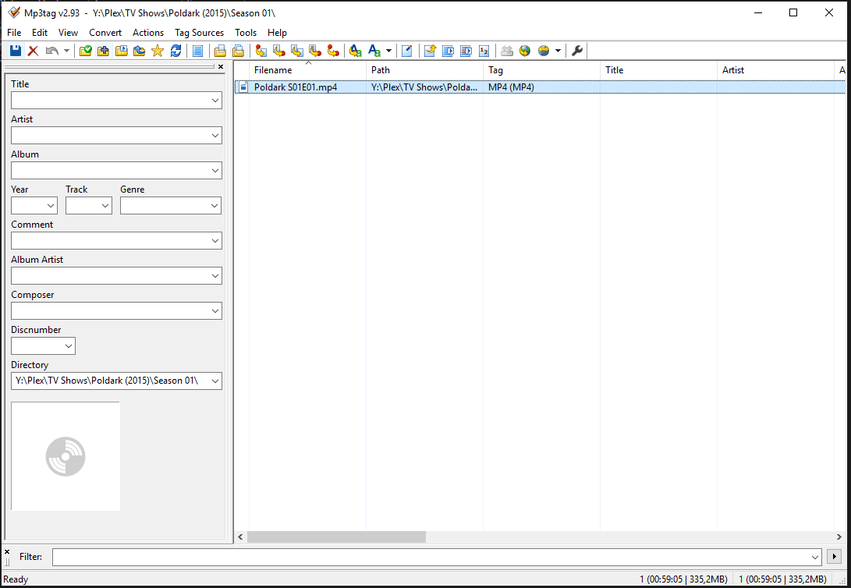

Exact naming of the episodes, from the root of your TV library and down to an episode please…
And screendump preferred
Sorry I forgot to attach it.
Please see attachedPoldark Naming Scheme
Check that the media files haven’t got a metadata tag set in the mp4 file itself.
(Also could check this by moving the Local Media Assetagent to the buttom, and then do a plex dance
I have tried that now and it’s still not working
Does the media files have an embedded title tag?
No
