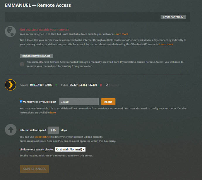

@ChuckPa I seem to be having the same exact issues - I have ran a plex server for over a year now, and upon reformatting and moving my server to a fresh install - i can not maintain a remote connection. It constantly goes from green to red intermittently and there is no access remotely on any devices.
All my ports are properly forwarded.
Please help, attached are my logs. Plex Media Server Logs_2020-10-08_22-45-25.zip (1.6 MB)
