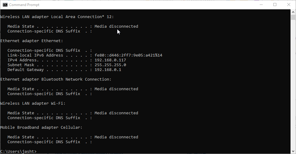

If this still fails, please give me the IP addresses of both QNAP and computer along with computer OS.

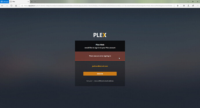

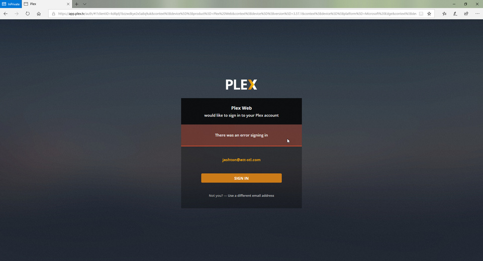

I just signed out of all browsers, closed them, opened one I don’t ever use in a private view and now I’m getting this error…
It’s better than nothing but not sure what to do next…any help is greatly appreciated!
Oh and I verified correct username and password twice.

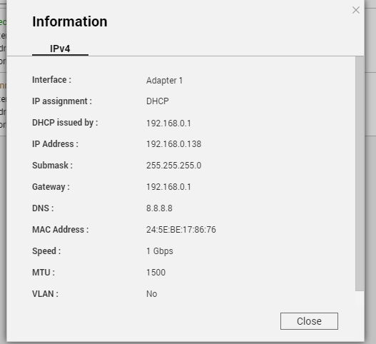

  2. Confirm your computer is on the same 192.168.0.x subnet as the QNAP
  3. In that tab, open http://192.168.0.138:32400/web (IP of QNAP)

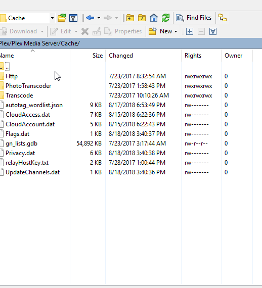

These are a couple screenshots. I used WIN SCP to view the files in the plex folder on my QNAP and there are folders with dates from back in July 23rd 2017 and others that I wonder if it’s not cleared out and causing issues. Just a thought…
