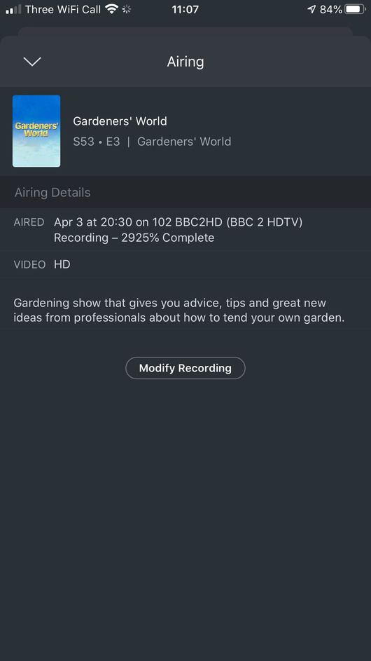

Still shows as recording. 2925% complete :sweat_smile:
Now even more failed + partial recordings. :frowning:

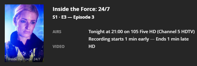

What I’ve also noticed is if a partial recording happens on a recording with minutes after end added - if the show is on another channel like +1 straight after the initial partial recording, it records another partial on the other channel as it starts the 2nd recording after the airing block has started. Maybe when it starts a partial, try reschedule at that stage to avoid another partial and get a full recording regardless of whether it has an end delay? My settings for minutes before start & minutes after end are both 1 minute.
Also reschedules for failed/partial recordings don’t seem to copy minutes before start & minutes after end settings for me :thinking:
