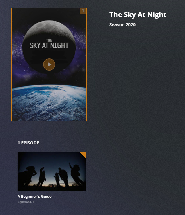

Has this ever been sequenced by episode numbers?
Shows are either season / episode number based or date based where the date is the original airing date for the episode
I have the previous episode as S2020E1 from when that originally aired.
Though that might have been a TheTVDB match, as the file name doesn’t seem to show any SSEE numbering.
I have referred this to our provider. thank you
Thanks for checking. I will leave this as is.

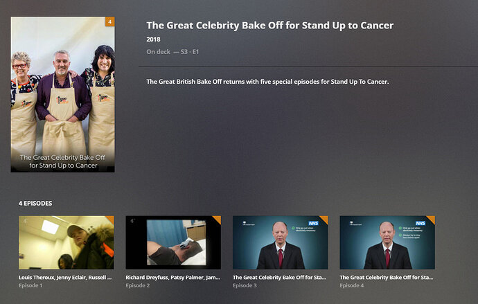

It’s been updated on 103, but not 003 for me. One channel has the updated SSEE & Episode name and the other doesn’t. Now have it recording twice in the schedule.
NEW removed, but still in my schedule with New Airings Only? Can be seen on Plex Web & iOS.
This has been fixed - the next two weeks airings now show as S3 E14 and E15
EPG Refresh should pick the changes
