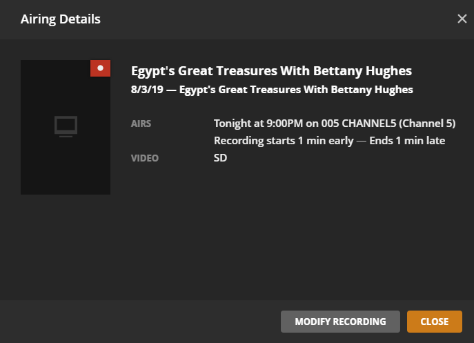

Set to Prefer HD, no channel limiting and Plex set it to record on the SD channel, when available on 105 (HD channel). Also doesn’t have NEW on either channels listings, when it’s airing for the first time today. It’s S1E1.
Egypt’s Great Treasures With Bettany Hughes not Recording on HD.zip (14.8 MB) (logs after scheduling it from 005 on the guide with Prefer HD enabled.)
If you go down the guide & set it to record on the HD channel itself at 9PM, it adds to the schedule as recording on the HD channel (105) - correct, just the outcome I expected the first time with Prefer HD enabled.
If you set all episodes to record, it has the same episode recording on 005 & 105 at the same time, then the same episode on 044 (Channel 5 +1).
This only seems to happen with Channel 5 airings with no Season or Episode number (just shows a date).
Tested with a few other shows that don’t have a Season or Episode number, on another channel. Set it to record All Episodes and just schedules one on the HD channel, instead of on the SD, HD & +1 channel.
Went back and tested a different show on Channel 5, with no Season or Episode number, Plex scheduled recordings on all 3 channels. 100% an issue with Channel 5 and shows with no Season or Episode number.

Freeview Meridian(South East) OTA Broadcast
Tonight at 9:00PM on 055 5SELECT
It Shows 8/8/19, but there isn’t an episode airing for the first time tonight. NEW indicator isn’t set which is correct. Plex had it scheduled originally to record, but not anymore. It recently did an EPG refresh. If the date shown on the EPG is meant to be the original aired date, it should be 8/3/19 but as it isn’t scheduled anymore, it isn’t much of an issue for me.

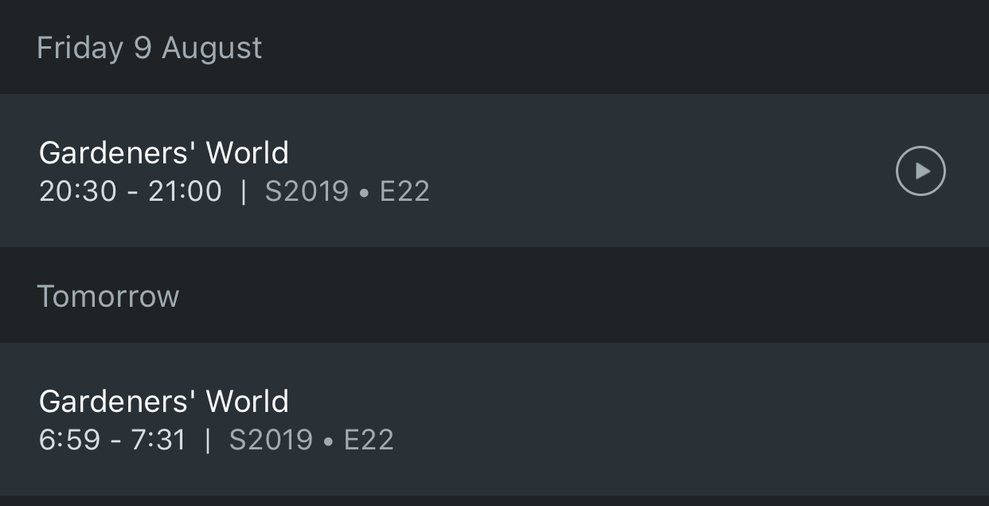

Gardeners’ World recorded Yesterday, now gone from Yesterday, and put under tomorrow 8/11 on Plex Web with a Play Button. Even has a totatlly different timeslot than the original recording yesterday.
Plex Web Debug Logs.txt (229.4 KB)
iOS shows it correctly, so must be something wrong with Plex Web.
Plex added it as S52-E22 yesterday after recording which is correct, but the guide shows S2019-E22 so maybe why it’s being scheduled again?

EDIT: Looking even further along the the Schedule, another weird tile on Plex Web for S2019E19 and even says Recorded Successfully. Doesn’t show on iOS. But the top scheduled recording is for Episode 19, which is in my library already too!
Fixed this issue. The new EPG has recently started stating S2019 when previously it just gave the date so didn’t match episodes on the EPG to existing recorded episodes in my library. (Plex previously matched them to Season 52 after recording, which I preferred)

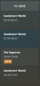

^ Also seeing the weird Plex Web Schedule bug again, for a different date.
