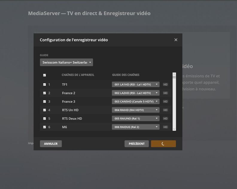

More or less same issue, Plex lost my previous config ⇒ no problem, it was announced.
I tried to reconfigure the DVR, but:
  1. It does not detect automatically the HDHomeRun ⇒ I had to insert the IP
  2. After the connection, It stays stuck like in the attached picture
    I tried with different guide provider and no change.
Some advices?
Some hints:
  • After a while Plex displays something like “device not found”
  • The windows HDHomerun player was also, not able to find the device. I had to update it, and it found it.
  • I just updated HDHR firmware to Version 20190621
