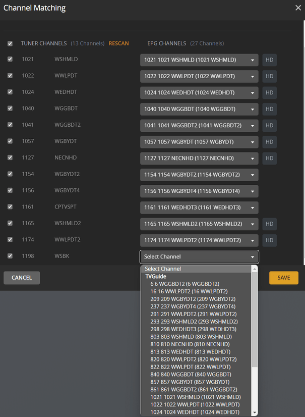

I just installed 1.25.5.5492-12f6b8c83 February 1, 2022 Ubuntu (16.04+) / Debian (8+) - Intel/AMD 64-bit
I did not refresh the DVR/Tuner, nor change the lineup from what I had on the old working version.
Channels all tune and play as they ought to.
I did a systemctl restart plexmediaserver and tried a few channels afterward. All was fine.
Well, here’s a small issue. Could be a bigger issue for others though.
I went to my HDHR channel lineup and clicked detect channels. Just to ensure Comcast hadn’t changed anything. X’d channels I don’t want leaving only the few I do watch using the new channel numbers.
Went to Plex and rescanned. The channels I marked as favorites in the HDHR are found and I can enable all but one. The one is 1198 and there is no 1198 in the guide.
There are other channels available in the selections that are not enabled in the HDHR.
I’ll attach screenshots of what I see.
Also, though the HD channels are marked HD during channel matching, if I choose HD channels in the guide, none are shown.
