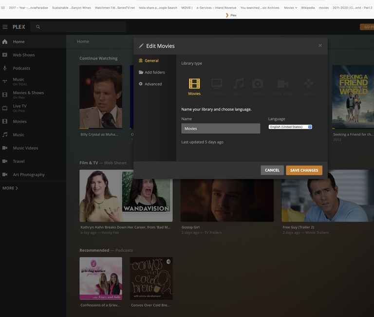

It looks like you’ve got some non-media directories added to your Libraries. I wonder if that’s contributing to problems.
If you edit the settings on a Library, what Folders are present?

Hi Tom .. here s what shows up when editing the library … wouldn t know the non media directories,
can you point me to them ?
Go to the next tab: “Add folders” and take another screenshot, please!

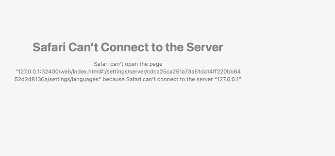

Plex server is crashing now without the TV connected, just starts up then crashes
a couple of minutes later

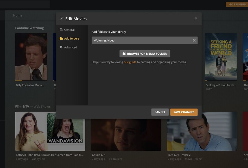

Please share some more details about your setup.
I take it /Volumes/video is a network drive (e.g. from a NAS)?
From the logs it seems like you have added your entire home folder to one of those Plex libraries (/Users/mrumrich/). As a consequence Plex is looking for media in the entire home folder, its subfolders and even the hidden /Users/mrumrich/Library/ folder (which contains tons of files that contain configuration information for apps and your account).
At the point of your crash, your Plex Media Server attempts to scan its own data directory (the folder where your server’s database and metadata reside). I suppose that’s causing some deadlock.
Please go through all your libraries and check the Add folders sections. Each library is perfectly ok to point to multiple folders. However each folder should be the parent folder containing your actual media (not 5 or 6 folders up/down).

From the looks of it at least one of your libraries is pointing at /Users/mrumrich/.

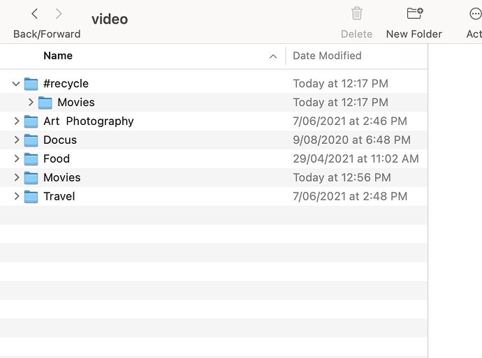

Hi Tom thanks for your reply. Decided to delete all folders and start again with a blank folder “Movies”. I will see if the structure I have on my NAS ( “video/movies” plus “video/Food” plus “video/travel” etc) will be showing up in plex “movies” and let you know how I got on. Faster than changing all folder/ libraries Cheers Mike
This is the sturcture I have on my NAS and I would like to have the same on the left hand sidebar on plex :
Hi Thom80H … new structure as mentioned seems to work, I might have caused “confusion” for the app by not correctly setting up the file structure / libraries in the first place. I m now pointing directly to the NAS, not having mrumrich etc included; looks like volumes/video/xxx iso user/mrumrich/xxx.
don t know if this fixed the issue, will monitor for a while and let you know, maybe this helps some one else. So far system has not crashed. Cheers M

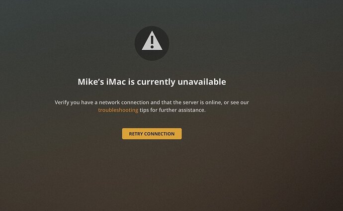

Thanks Thom, I do have the PMS installed on my DS 416 (maxed out RAM 8 GB) but can t access from the TV app … when I try to set up ip for connection 1 with the NAS ip address and the port 32400 the system tells me that the server is not accessible … not running a beta so it should work, wonder where I am going wrong … Cheers Mike
Check if you’re running the server and clients from the same Plex account. If you do… are the libraries of the 416 maybe already showing in the more section of the main navigation?
Another troubleshooting step could be to verify that the tv is hosted in the same subnet, otherwise client and server won’t be able to see each other.
