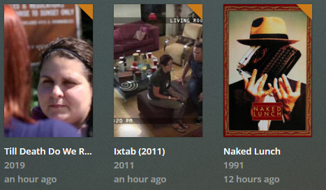

Lately I have had a few movies refuse to match. This problem seems to have gotten worse lately…
The two that I have tried hardest to fix are these:
Ixtab (2011)
https://www.imdb.com/title/tt2340426/
Till Death Do We Rot (2019)
https://www.imdb.com/title/tt11368116/
IMDB doesn’t seem to think there is anything weird about them.
I tried every sort of matching trick, including putting the IMDB reference number (tt11368116) in the search field and nothing.
The files and directories had scene type filenames (Movie.Tile.Year.Groupname.avi) so I moved them out, and changed the filenames and directory names to Till Death Do We Rot (2019). I then followed the instructions to clear the database here:
https://forums.plex.tv/t/unlink-movies-change-missed-up-metadata/529508/2
Including the “Plex Dance” here:
https://forums.plex.tv/t/plex-incorrectly-identifying-tv-episodes/100265/4
When I tried ti scan files again, it just imports the name as the old scene-looking filename, even though that name no longer exists. If you do a Get Info on the newly imported record the filename is correct but the name on that record is the old filename for some reason.

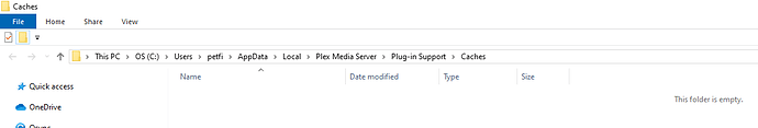

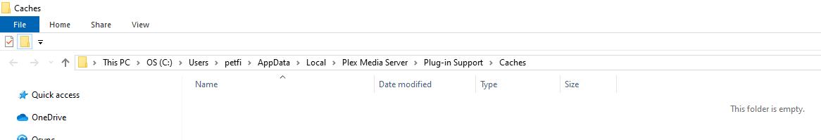

I tried to redo the match, with all of the different combinations but all of the search results are cached somewhere and it returns “Result Not Found” without actually searching. I tried to clear the caches as described here:
https://support.plex.tv/articles/202967376-clearing-plugin-channel-agent-http-caches/
and there are no files in that directory.
%LOCALAPPDATA%\Plex Media Server\Plug-in Support\Caches
So they have imported with the old filename and I cannot match them.

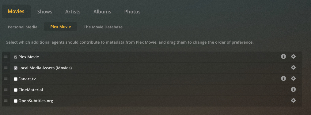

Are they mp4/m4v files? If so, the embedded metadata may be causing issues. Leave your corrected file names in place and change your agent settings such that Local Media Assets is at a lower priority than the primary scanner for the agent (Settings -> Agents):
I’d do this for both Plex Movie and The Movie Database. Then, try the Plex Dance again. If that doesn’t work, try a Fix Match on them and use The Movie Database as the agent. I’ve read elsewhere on these forums that the Plex Movie agent can have issues with movies whose IMDB id has 8 numbers in it.

change your agent settings such that Local Media Assets is at a lower priority than the primary scanner for the agent (Settings → Agents):
Already done that, for all Agents.

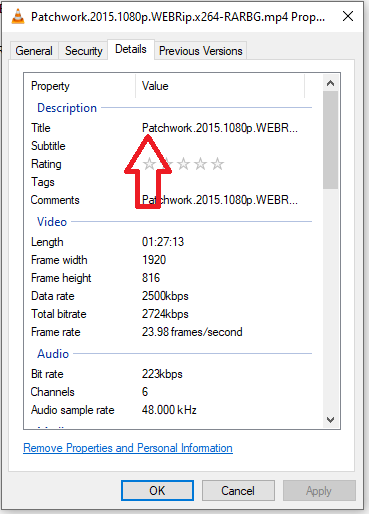

OK, I got them imported with the right file names. I did this by editing the metadata on the mp4 file to match the new file name.
You can do this by right clicking on the file in File Explorer and selecting Properties. The old filenames are in the Details tab. You can change then there.
Then, after the Plex Dance, it comes in with the correct filename. It still doesn’t match.
And then when you try to match it, nothing happens because is returns the cached results from previous attempts. You can tell it isn’t searching because it returns the result immediately. I still can’t find any way of clearing that cache, wherever it is.

Do also move Local Media Assets to the bottom of the stack of active agents under ALL tabs in Shows and Movies:
Red - where it was
Green - where it goes
All names should precisely follow the naming guide. Your file names are great examples of what NOT to name your files.

I did that, and even showed a picture.
Renaming the files was about the first thing that I did. My point was that Plex was deriving the old filename from within the file metadata, which can’t be seen in any way other than how I showed above.
I have the recorda in Plex, with the correct names, and they won’t match. They are not even searching, as they are pulling the results from a cache that I seem unable to clear.
I have done that multiple times now. It is still pulling search results from a cache.

Try clearing your lMDB cache - same place as TVDB’s cache:
Yes, I did, and posted the link that I got the instructions from.
Yes.
I did that, even posted the link and file location that I used.
Did you restart the server?
There should be new folders written for the ones you delete, and I’m pretty sure that happens on a restart.
Just restarted the server. Still no files in that folder.
