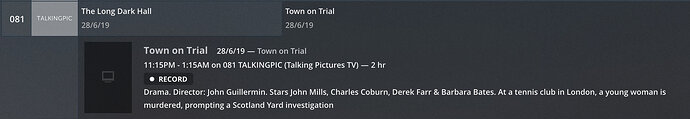

Things seem to have improved now. I’m getting the right lineup for my region (“Freeview STV Central OTA Broadcast”) but I’m still seeing problems with programmes on Talking Pictures being identified as shows rather than movies and with odd air dates:
Is there anything I can do to help remedy this?
Spoke a little too soon. Both the BBC Scotland channels (SD on 9, HD on 115) get “Radio Programming” on the EPG, and trying to play them results in BBC 6 Music (channel 707) playing instead.

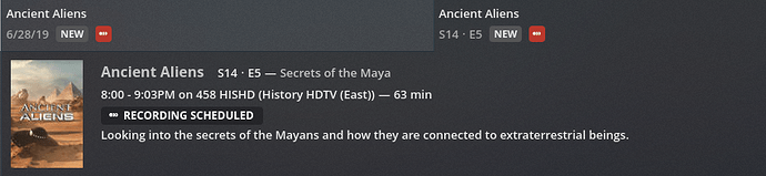

The other series I was having an issue with is Ancient Aliens. Tomorrow shows 2 new episodes in the guide on Plex. The first episode that shows as new is actually a repeat from last week, but it doesn’t show a season or episode number, just 6/28/19 (which at least lets me know it is an old airing). The next airing that actually is the new episode is listed as S14 E5 (although it has the correct episode name) when it should be S14 E6, and that’s why it doesn’t show up in my list of scheduled recordings, because last week was actually episode 5 of the new season.
