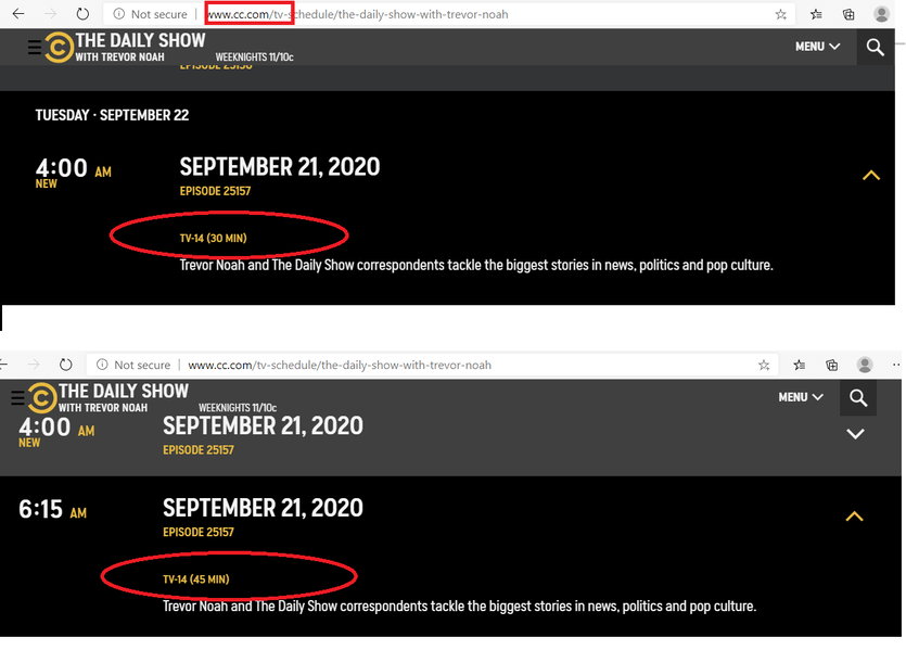

This appears an issue with the channel’s own schedule. See TV Schedule | Channel Finder | Shows, Episodes | Comedy Central
They have some airings showing as being 30 minutes instead of 45 minutes and this is reflected in our EPG
The EPG reflects what the channel is providing
EPG schedule data
The airing times in the www.cc.com schedule screenshots are for my timezone (BST)

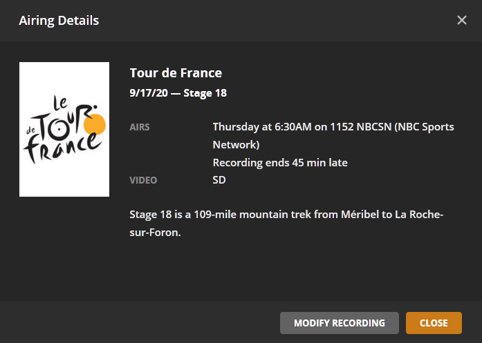

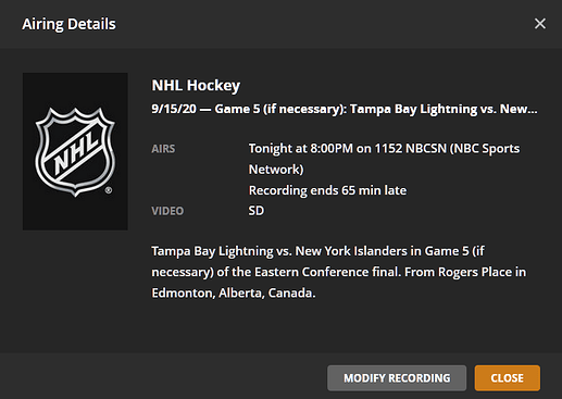

It isn’t that the channel is marked SD instead of HD (or at least I don’t think it is):
As you can see 1152 NBCSNHD is marked as ‘HD’, but most (all?) of the shows on that channel are marked as SD when they definitely are not:
I want to say that I’ve seen similar behavior on other channels - but at the moment I can’t find any examples so the issue might just be on this one channel.
The channel itself has 2 entries in my channel guide (most of the channels do) but neither one has been SD for years, and I have only enabled the higher-numbered channels in my DVR setup in an attempt to prevent this issue but it hasn’t done anything.

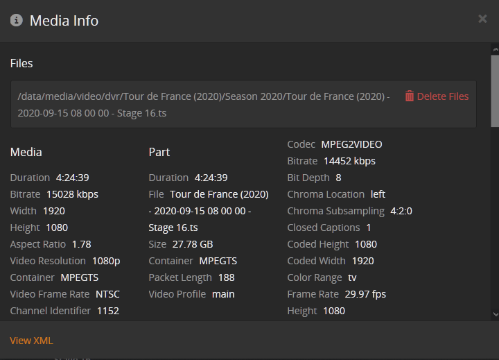

I am not sure why the program data thinks the airing is in SD - after it’s recorded the video data confirms that it is HD:

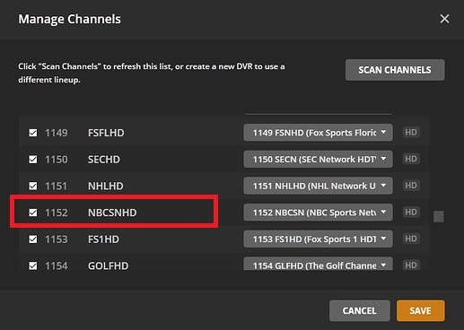

Thank you. I can see that 1152 is HD channel NBCSNHD but the lineup does not have it as that but as the SD channel NBCSN
They did approach Spectrum to get info on which channels are HD and which are SD but Spectrum have not yet responded. I have passed this screenshot to our provider as evidence of 1152 being an HD channel

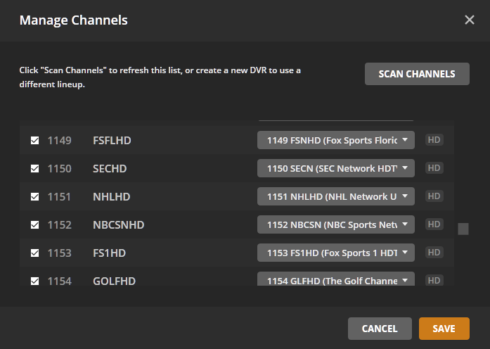

Could you see what the tuner shows for 49 and 102 - are they both SD ? The tuner channel details is on the left side on the channel mapping dialogue box
49:
102:
Both are HD.
I can definitely understand how it might be confusing - nearly all national channels are duplicated at least once in the channel lineup, but for years none of those national channels have been SD, all should be HD (and show that in the channel scan if not the EPG data).

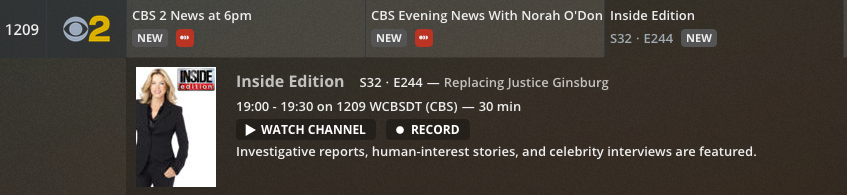

Please Plex, Bring back GraceNote! This is a total nightmare. I’m sure that we would prefer this over this disaster DVR Live TV guide.

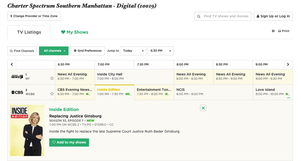

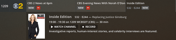

Most of the episodes are totally incorrect. Have a look at Gracenote’s compared to your Guide data. TV Listings- Find Local TV Listings and Watch Full Episodes They are totally different! Gracenote’s guide data is correct. Please have a look at the comparison for one show ‘Inside Edition’ You will see that it is correctly listed as S33E07. Plex’s TV guide is totally wrong as it lists it as S32E244! This goes for most series with Plex’s Guide. None of my recordings are working anymore so I have been forced to use Emby to record the correct episodes. Only wish Emby had detect and remove commercials.
PS: I’ve tried Schedules direct and wasted money on that since it can’t even categorize News. It recognizes all news programs as Movies. Plex won’t allow me to save it in my created News folder. If anyone has any ideas on how to get a proper XML file for the TV guide on Unraid, I would love to know.
Again, start from scratch and rebuild this utter disaster of what Plex calls a DVR. It’s totally useless. This issue has been going on since June 2019!!!

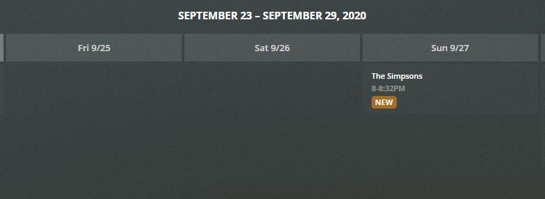

DVR—Verizon FiOS Burlington Digital
Channels 8/508
All of FOX’s Sunday animated block is set to debut this Sunday. And while “The Simpsons” is currently scheduled to be recorded, Family Guy is not.
