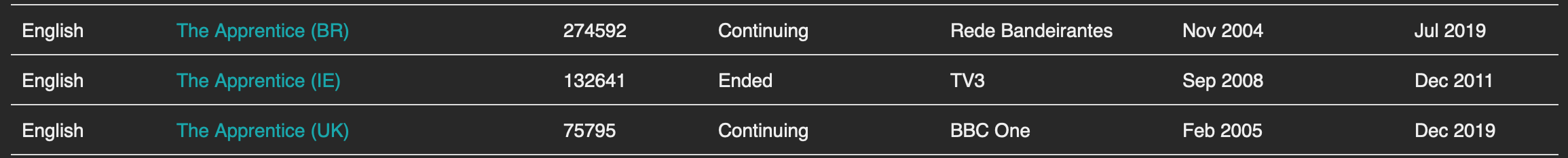

The Apprentice (2005) > Season 15 > The Apprentice (2005) - S15E01 - South Africa.ts
So that all appears to be correct!
On TheTVDB they have it down as ā€˜The Apprentice UK’, so maybe it is just picking the first ā€˜The Apprentice’ it finds?
e.g.
My initial tests setting up a library with dummy file with that path did result in mapping to ā€œThe Apprentice (UK)ā€
So I will need to get debug logs zip after a recording is completed and the identification goes wrong

Well the episode recorded tonight has retrieved ā€˜The Apprentice (IE)’ meta data again.
Log entries:-
Looks like they both gave a match of 101 and then for some reason it gave ā€˜The Apprentice (IE)’ a final score of 102!
If you need more from the logs, please let me know.
Yep matches to IE version again for me (as it has some for the past couple of seasons). @sa2000 just let me know if you need anything from my logs too…
I have reproduced the problem. For some reason the UK series got a bad score from one of our services which I think what resulted in the IE initial score getting bumped up by 1.
I will be discussing this with the team that manages the system which I suspect to have the issue
Excellent, thank you - out of interest is there a wee guide that explains how this scoring/matches process works?
I am afraid not. It is quite complex and data is pulled from a number of sources
I believe I know now what the cause of the issue and it can be fixed temporarily by doing a Plex Dance after the recording and the mismatch
OK thanks, I hadn’t heard of the dance before but will give it a go!
I understand now that ā€œFix Incorrect Matchā€ does affect future scoring - so that would be a better option. The more users do it the higher chance of scoring getting better and leading to the right series being matched. The issue here was that we do not include the originally aired year for the show when trying to match at the end of recording - this may be deliberate - I have referred it to our development team
Ah OK, no problem - have gone down the ā€˜Fix Incorrect Match’ route instead. What I find confusing in there is the top two entries (both scoring 100) are just called ā€˜The Apprentice’, with 2008 and 2005 start dates. However the 2008 one is clearly the Irish one, but (IE) only shows up when it’s selected. For shows in multiple countries it would be good if the country could also be shown to make it easier to pick the right one. Once 2005 selected it does indeed show (UK) after it, but not in the Fix Incorrect Match list. Hopefully this would encourage more people to pick the correct one.
