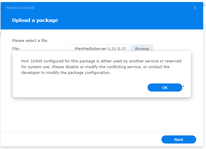

I tried installing the Plex DSM 7 from the download link in posted in DSM 7 - Plex Media Server forum preview. I get an error that port 32400 is in use. I tried removing that port from the port forwarding configuration on my DS916+ and in desperation uninstalled the DSM 6 Plex install.
How do I get around this?
You probably need to stop the old instance that is still running and blocking the port:
sudo /var/packages/Plex\ Media\ Server/scripts/start-stop-status stop
Thanks for all your effort today! I’ll try verifying if hardware transcoding works if I disable subtitles tomorrow.
If you have any additional tests I can do, or want access to my synology / pms, let me know
You are probably right, but I removed my old install of Plex, so those files don’t exist anymore. I am probably hosed and will have to wait on the good work of the Plex folks here.
Removing it probably didn’t fully remove it. Try making a task with this and run it.
If not, maybe you’re running it on docker still?
/var/packages/Plex\ Media\ Server no longer exists on my Synology.
You can try opening ssh and using the PS command to get all your processes. Find plex and run
kill with the plex process ID.
@Darkrogue That seemed to do it. Thanks!
