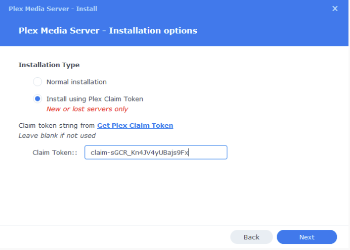

Ultimately I guess I’m wondering if I can just go to package center>plex>Manual install, choose that PlexMediaServer-1.23.6.4881-e2e58f321-x86_64_DSM7.spk and run or if I have to uninstall>leave folder/files and claim token method. On that part if needed do I have to get the “token” first from somewhere is is there when I go to install using claim token.
Sorry, just trying to not create churn unnecessarily by going left when I should have gone right
@gporter416
See the blue hyperlink “Get Plex Claim Token” on the installer page ?
Click it :slight_smile:
Your browser will open and Plex.tv will give you a claim token
Click Copy
Come back to the installer and paste it into the ‘Claim Token’ window.

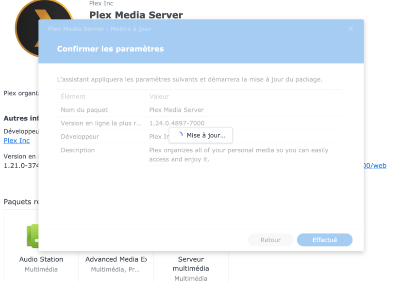

I probably should have looked for the tuto before doing it thinking it would be easy …
I did my DSM6 upgrade to DSM7.
I got an error message that the package needed to be repaired, so without thinking too much I clicked on repair.
Of course it didn’t fix anything.
From there I looked for a tutorial. I did change the permissions for the Plex directory and the directory that contains the media.
My knowledge is quite limited, I admit.
My problem now is that when I try to install manually the plex package, the process remains blocked for > 25 minutes (I mean that updating animation never ends). Usually, this operation takes 30 seconds at the most.
Can this is explain by my media library size ? (if huge)
@TabasKo
Yes, you need to read the instructions.
Installation will take time. approximate 2 minutes for each 1000 items you have indexed by PMS
Before you have any further problems, open a new window to DSM and increase the idle timeout delay to 65535 minutes. You can restore the default value later.
Doing this will allow the display to stay signed in.
It just ended at the second one ! :sweat_smile:
I had interrupted the previous installation after 10 minutes by rebooting the NAS. And I really thought that it was a big mistake and that I was not going to make it.
I am relieved.
Thanks for your quick feedback anyway
