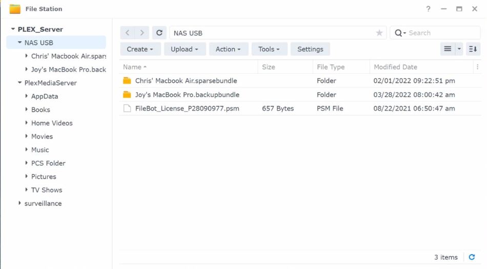

This is how it looks from the File Station :
When pointing PLEX to find media, I can’t drill down past the MEDIA folder … which means I can’t select movies, TV, etc…
You’re welcome, and I get what you’re having an issue with.
I put all my Folders and files under the PlexMediaServer folder. Works like a champ.
As a sidenote, I’d get a decent USB storage drive of some kind and move your Time Machine backups there. No need to clog up the NAS and streaming with endless MAC backups hehe.
