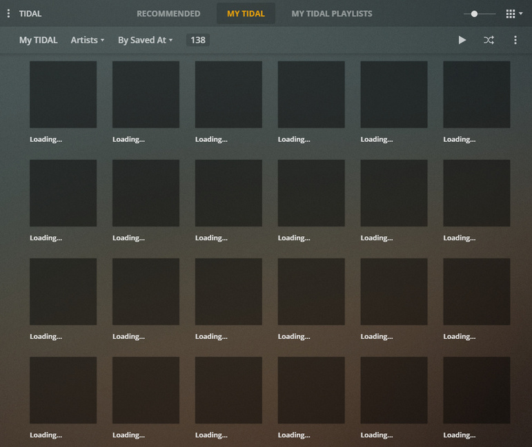

Whoop-de-doop… I have solved the issue that is affecting me! Only taken 6 months and zero (proper) assistance from Plex!
So… if you are having this issue, log into Tidal and go to your ā€œAlbumsā€ list, and sort by ā€œArtistā€. Then, you need to click on every single album to see whether the album has been removed from Tidal by the distributors. Eventually, you should reach a point where the ā€œMY TIDALā€ tab starts to work.
Personally, I think this issue is a combined issue for both Plex and Tidal. Tidal should handle the removal of albums better, while Plex should have better detection when it encounters an album where it cannot retrieve the metadata for it. I believe it is when Plex is retrieving the metadata ā€œper albumā€ from Tidal that this failure is occurring.
Hopefully, this will help somebody else :slight_smile:
Looks like I may still have some albums to remove… but at least I know where to go from here.
