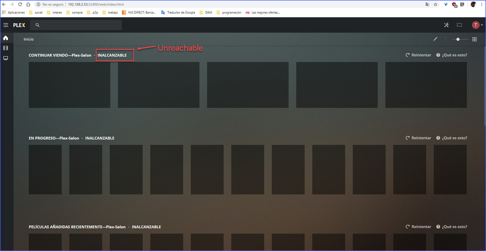

I just tried to connect from my laptop to the ip:32400 and i can connect perfectly to the server, but even there, its say that he is unreachable-

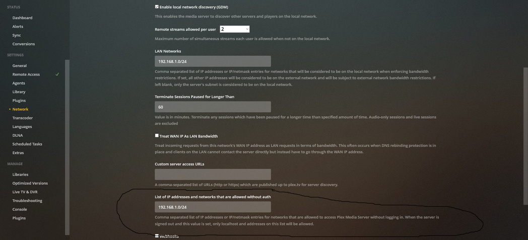

  1. Did you provide the List of IP addresses and networks that are allowed without auth ? The steps are in the doc I linked above previously. Go to Settings > Network > enable Show Advance settings in the top right. Put your router ip in here – would be something like 192.168.2.1/255.255.255.0 (I’m assuming this based on your IP of 192.168.2.53). This is needed for local devices to access your server without authentication which I think you are trying to do.

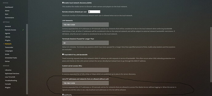

Just for a visual aid of what dokuro is talking about:
You specifically want the box that mentions “without auth”. The other very similar box is meant for deciding which IPs to apply bandwidth restrictions to.
So in the “without auth” box you’d enter something like 192.168.2.1/255.255.255.0 or 192.168.2.0/24
What that is telling Plex is that (assuming your local network uses 192.168.2.x addresses) devices connecting from an IP address of 192.168.2.1-192.168.2.254 are allowed to connect without authentication.
If your local network has more than one “subnet”, let’s say your main network is on 192.168.1.x and you’re connected to a “repeater” or something that uses 192.168.2.x, you’d need to add both separated by a comma.
I forget if you add a space, but something like: 192.168.1.0/24,192.168.2.0/24
I struggle a bit with subnets/notation, so if that’s not written correctly definitely invite someone to restate/rephrase it.
I did all that, but nothing worked
Yes i did it. But it didn’t work. That’s why i feel so frustrated
