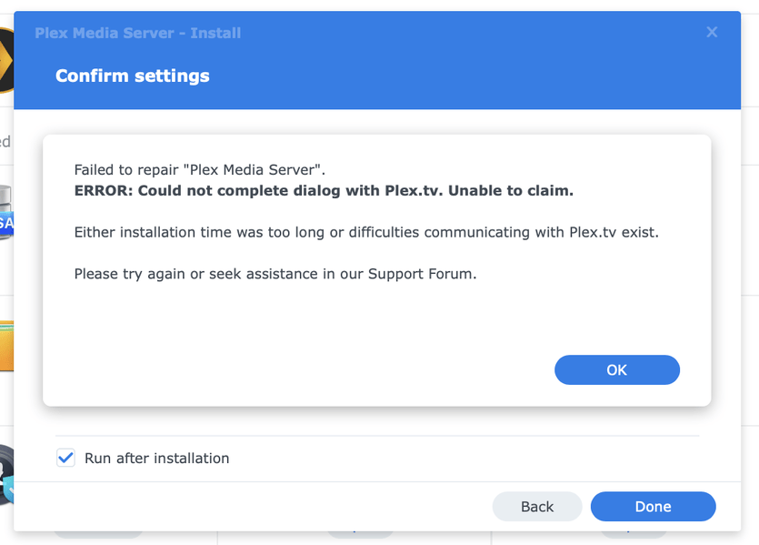

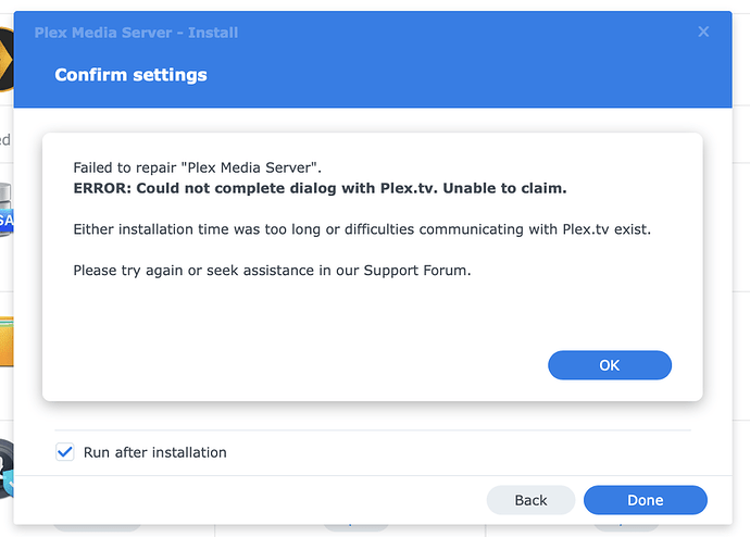

Someone please help lol i had to move my synology and internet setup to another room and my synology loads up perfectly fine BUT my plex kept saying cannot find this server / i dont have permission to view
so i uninstalled but kept plex info for future re-installation. went to re-install plex using the key method and i keep getting the error
Logs.zip (2.8 MB)
any thoughts?
