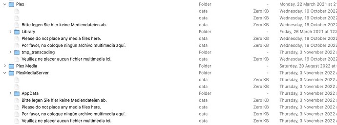

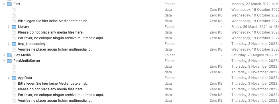

Except I now seem to have a duplicate Plex server folder.
The one called ‘PlexMediaServer’ seems to have been added with the new installation after I upgraded to DSM7.
Is it safe to delete this new one?
It seems you missed that in my DOCUMENTATION
The new shared folder name is PlexMediaServer and can ONLY contain the server internal files under AppData
The Plex shared folder and user Plex have been abandoned in DSM 7.
I would have removed both but DSM 7 does not grant that privilege to apps anymore (I am no longer ‘root’ while installing).
Look very carefully in the “Plex” share.
You should NOT have Plex/Library/Application Support/Plex Media Server.
Migration takes the Plex Media Server directory, processes it, and then moves to PlexMediaServer/AppData/Plex Media Server
If you wish to keep the “Plex” shared folder for your media – you are free to do so.
Use or dispose of as you wish
