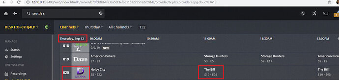

further to my earlier posts this shows that the data is there. We just need to understand why you cannot see it. Are you signed into the app with your Plex Pass account? And have you done a full EPG refresh before checking?
I’ve just done a manual one rather than the overnight and it’s now showing correctly, thanks!

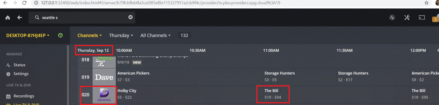

Bill showing on 13th but not 9,10 or 11.
Am signed in with Plex Pass account and not visible on web or IOS apps.
Showing on drama guide for 9 and 10 currently, https://drama.uktv.co.uk/tv-guide/
Screenshot added and refreshed earlier today and just before posting as well to make sure.12|690x314

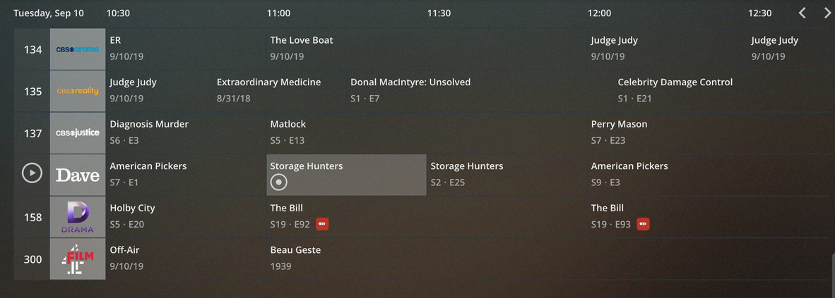

Can you get me screenshot of the the Grid View for 10th September for 11am
Click on Live TV and then select Tuesday morning and move time to 11am
Thanks.
It’s showing in guide, but not in scheduled recordings.
That would need a completely different investigation from I and another person went through following your earlier post saying it disappeared
When you open up the two episodes in this guide screenshot, does it show it as scheduled to record ?

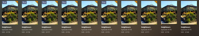

Just to update - Neighbours is now back to doing its ‘two recordings in one’ trick that it had stopped doing a week or so ago. Presumably guide-data related…
