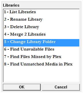

@anon18523487 might be worth adding to your tool?

I’m sure many people will thank you for adding this.
Joseph Elwell.
Thank you for adding that.
Doesn’t look like there is a way to mark that I answered my own question. Which really isn’t very surprising.
Edit to note that MovieFan.Plex was never going to edit the tool to support this.
