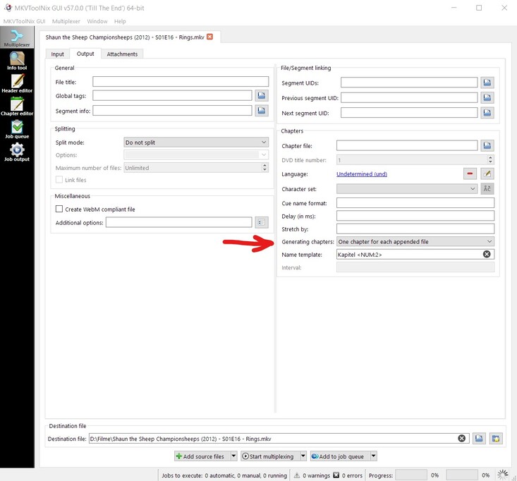

  • start up MKVtoolnixGUI
    (depending on your operating system this might look a little bit different)
  • drag the first part file into the window marked by my crude arrow
  • the video, audio and subtitle tracks it contains will appear in the window underneath it
  • Right-click on the File name of the first part and choose ‘Append files’. Navigate to the file for the second part and select it.
  • Your screen should now look like the screenshot below. Note, how the filename for the second part is ‘indented’.
  • you may want to revise the language code that is assigned to the audio track(s) and the language and ‘forced’ attribute of subtitle tracks so the Plex interface informs you correctly about the languages available. Plex’s automatic audio and subtitle track selection feature relies also on these tags to work correctly.
  • Now we correct the ‘Output file’ name to Plex standards to ensure a successful matching.
    Filmtitle (year) [extraneous info which is not mentioned in the movie naming guide].ext
  • ‘Start Muxing’
Done.

One thing I would add is to make sure you use MKVToolNix after you are done to fix your chapter names.
Otherwise you will have chapters that look like 1-30 and then 1-28 (so after 30 isn’t 31, but 1 again).
Easy to fix in the same tool, just use the chapter editor to rename the chapters and save when done.
Not critical, but was driving me crazy. :wink:
